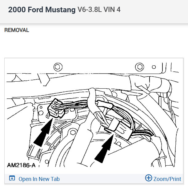

My A/C was working fin then all the sudden it doesn't turn on anymore, it won't blow any air at all.

Hey Chris,
Can I ask if the air not blowing is the problem or the air is blowing but not cold? Please let me know so we can head in the right direction to fix it. :)
Dec 9, 2024 at 12:53 AM
CHRIS KINARD
  • 94 POSTS
It's not blowing any air.
Dec 9, 2024 at 12:54 AM
  • 55,649 POSTS

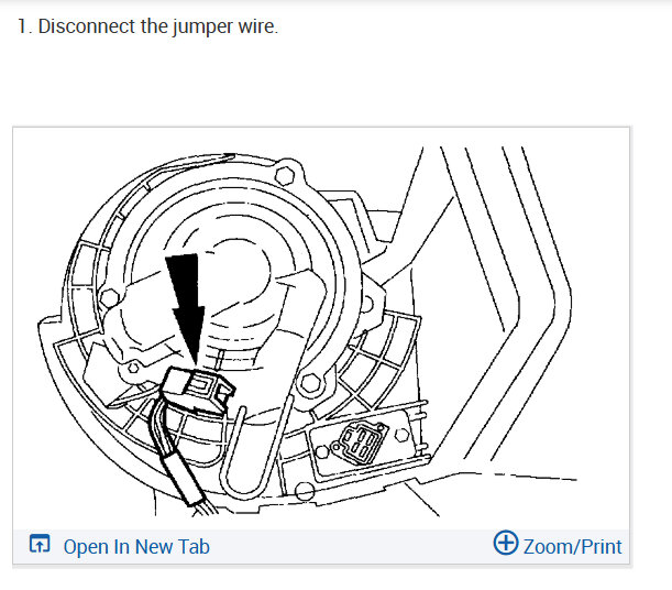

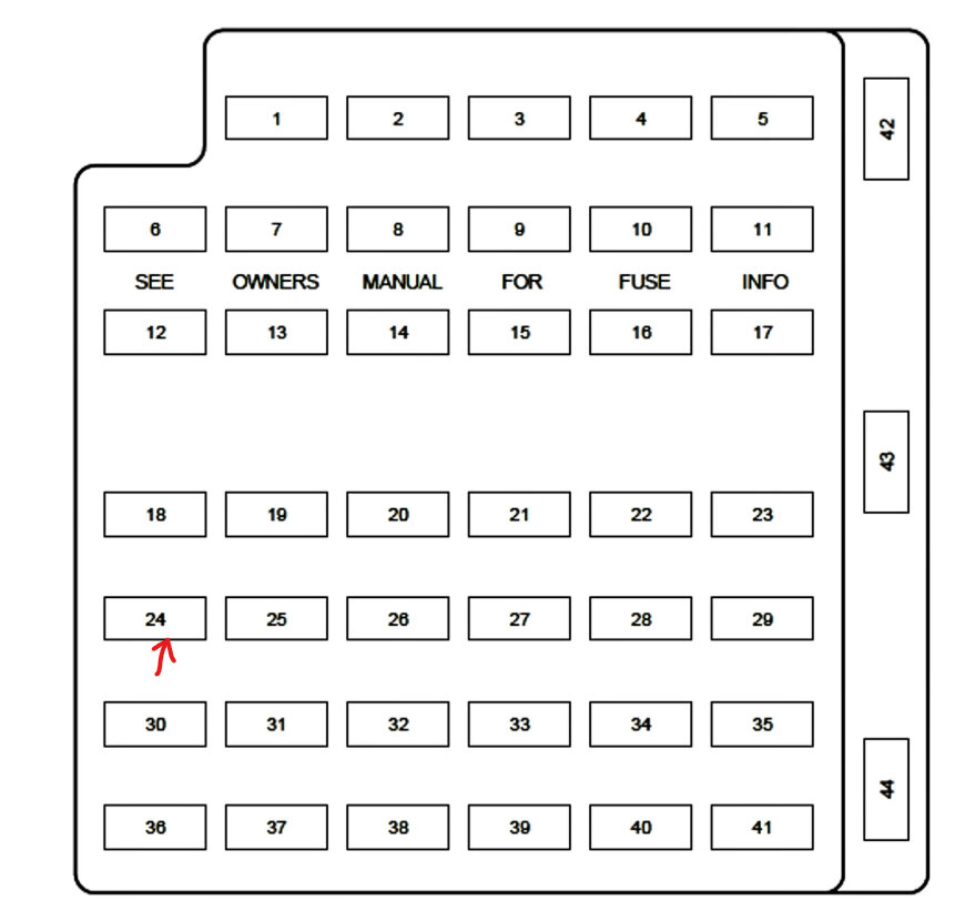

Okay, most of the time it will be the lower motor but as should check the fuse #24 which is under the fuse panel.
Here is a guide that can help and the fuse location in the diagrams below:
Check out the images (below). Let us know how it goes.

The fuse is good.

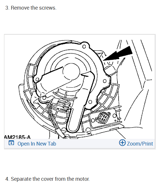

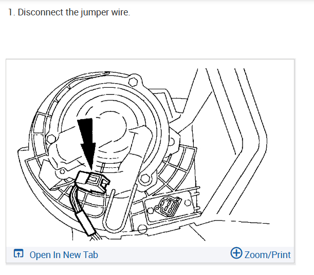

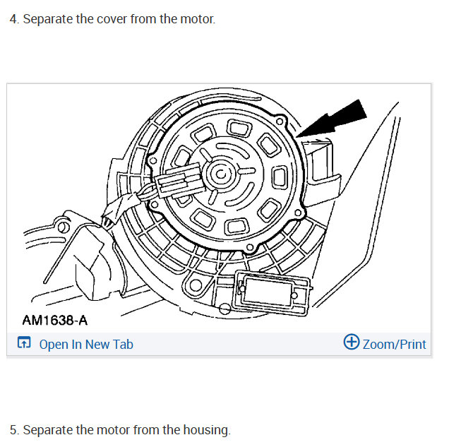

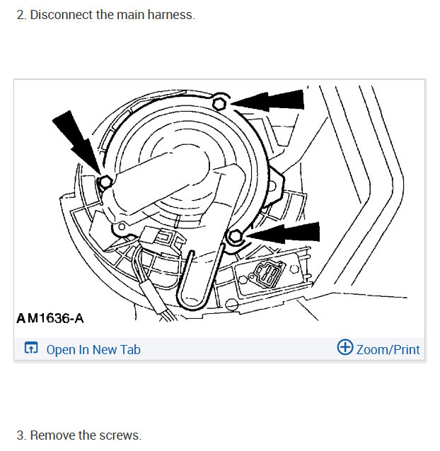

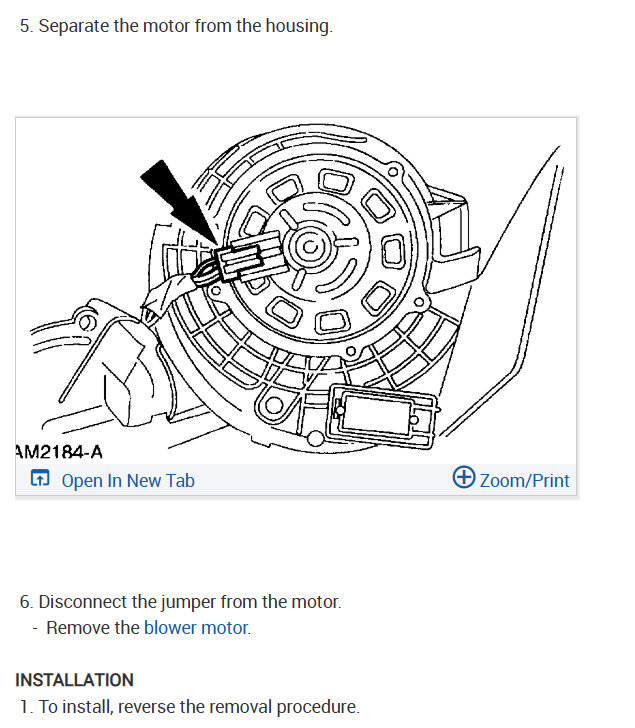

Okay good, let's use this guide to check for power and ground at the blower motor, chances are the blower motor has gone bad but this will confirm the problem.
https://www.2carpros.com/articles/how-to-test-an-automotive-hvac-system-blower-fan-motor-a-detailed

Yep, this was most likely the blower motor burning up, does the fan motor not wok at all speeds?

Up, chances re the blower motor is bad, I would use the guide above to confirm the issue and then replace the blower motor.
