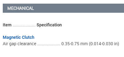

Okay thanks. Is the a special tool I need to take it off and would you know if it is readily available? I have seen some on amazon and are there shims I must keep and maintain a gap? I have been watching some YouTube.

Hello, I'm Danny.
Just to add my two cents. I've attached air gap specification below as a picture. A/C clutch removal/install tools are available at any local auto parts store in their tool loaner program for rent.Hope this helps and thanks again for using 2CarPros.
