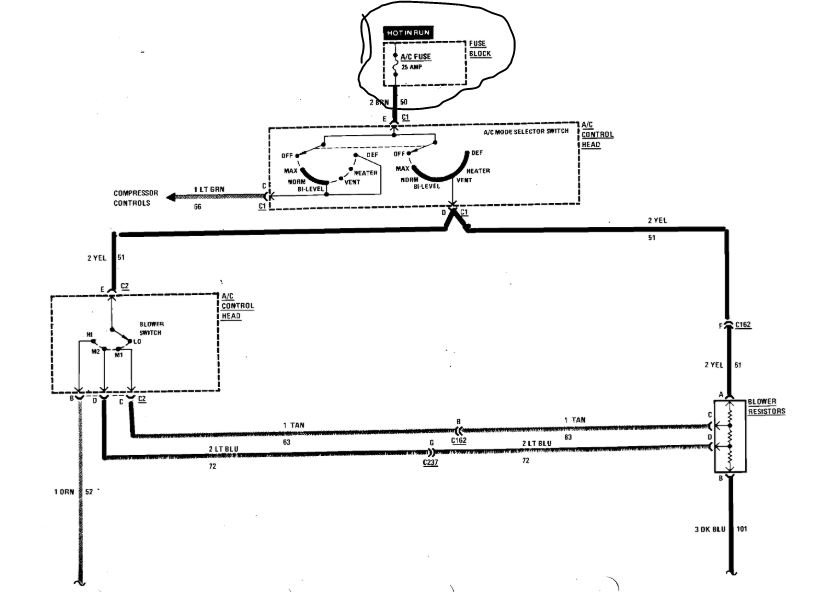

The A/C compressor will not go on the air conditioning and heater fan will not go on all. the gauges on the dash seem to work and indicate things are okay.
Nov 7, 2019 at 12:22 AM
Good afternoon,

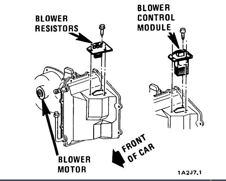

I attached 2 diagrams for you to view. Check for power at the fuse listed in the first one and check for power to the blower resistor in the second one.
