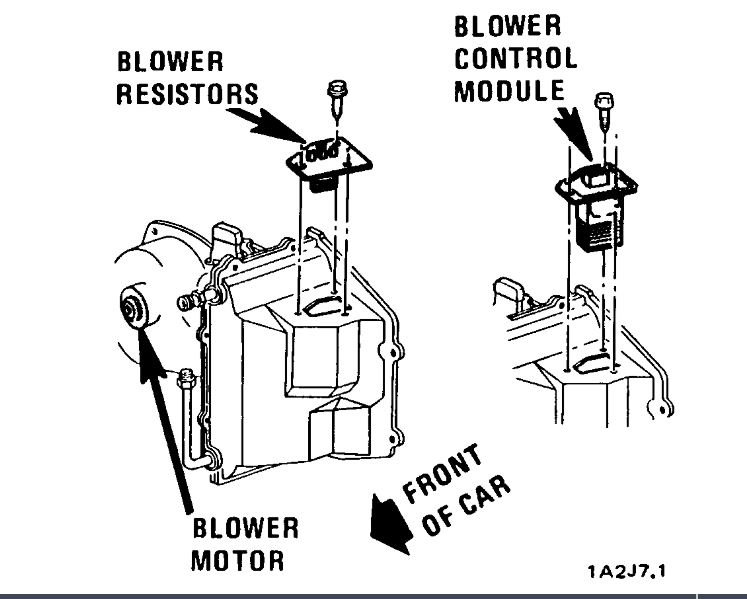

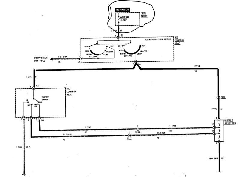

The A/C compressor will not go on the air conditioning and heater fan will not go on all. the gauges on the dash seem to work and indicate things are okay.

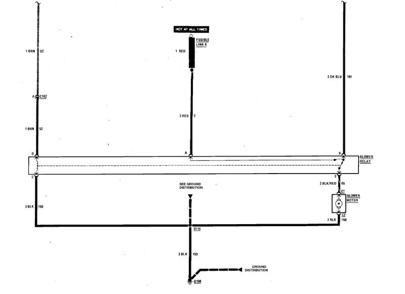

I attached 2 diagrams for you to view. Check for power at the fuse listed in the first one and check for power to the blower resistor in the second one.
