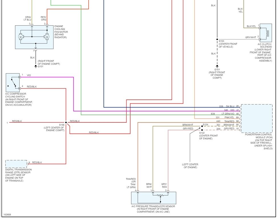

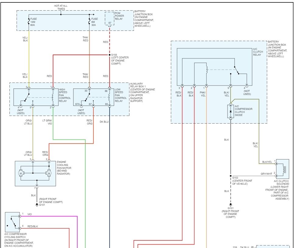

My A/C unit is not coming on. Fan works but no cold air. Compressor not getting signal to engage clutch. Freon level is okay.

If you are sure the freon is ok, you'll want to check the fuses to be sure the clutch is getting proper power. It could also be a bad pressure switch, relay, or even wiring. Please look over these schematics and let me know if you have any questions.
Clutch relay is controlled by PCM, but powered through switch that gets power from fuse 34
