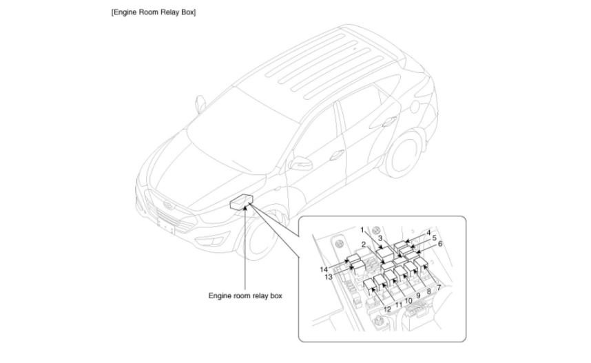

I am trying to find the AC clutch relay on the vehicle listed above. Where is it at? The AC is not working.
Apr 23, 2018 at 4:42 AM
Good evening.

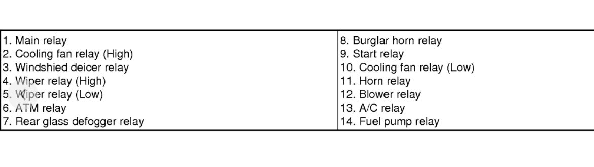

The relay is in the fuse block. I attached a picture and legend to identify relays. Check out the diagrams (Below). Please let us know what happens.
Apr 23, 2018 at 9:53 AM
