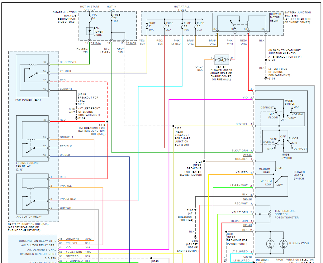

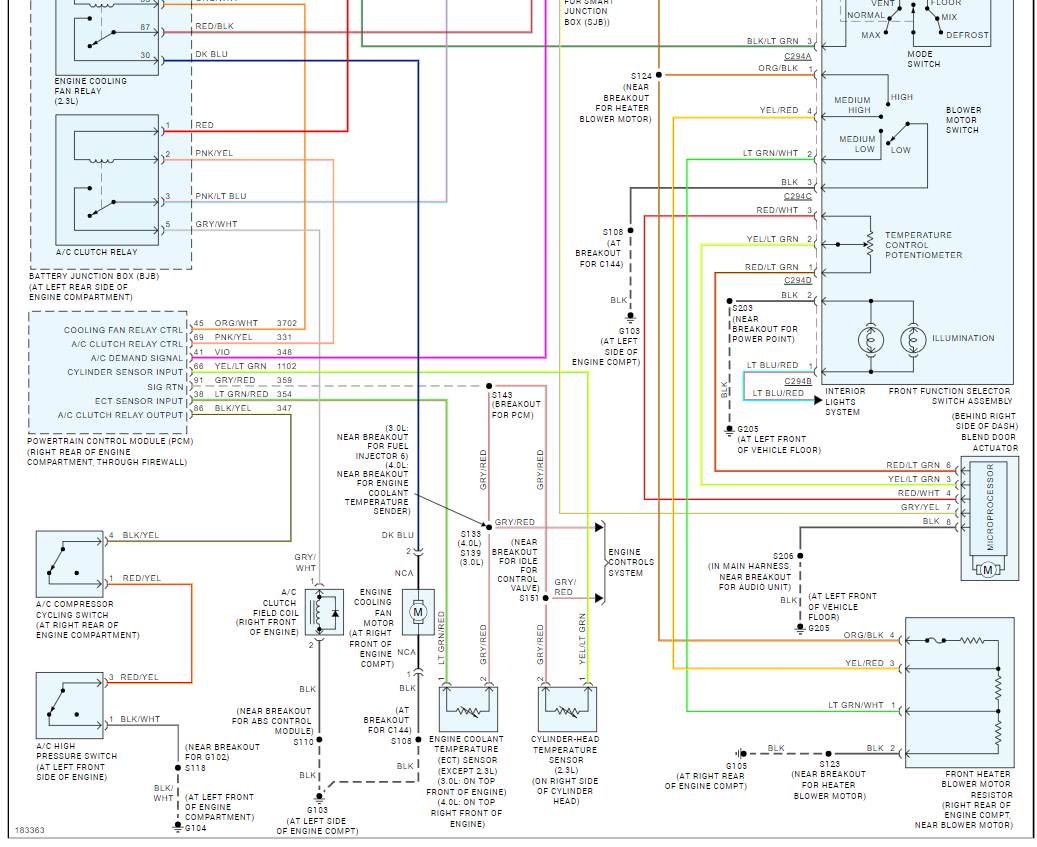

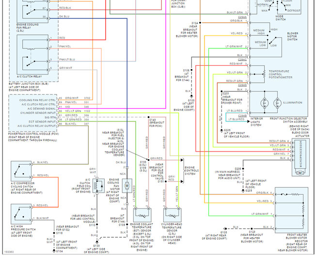

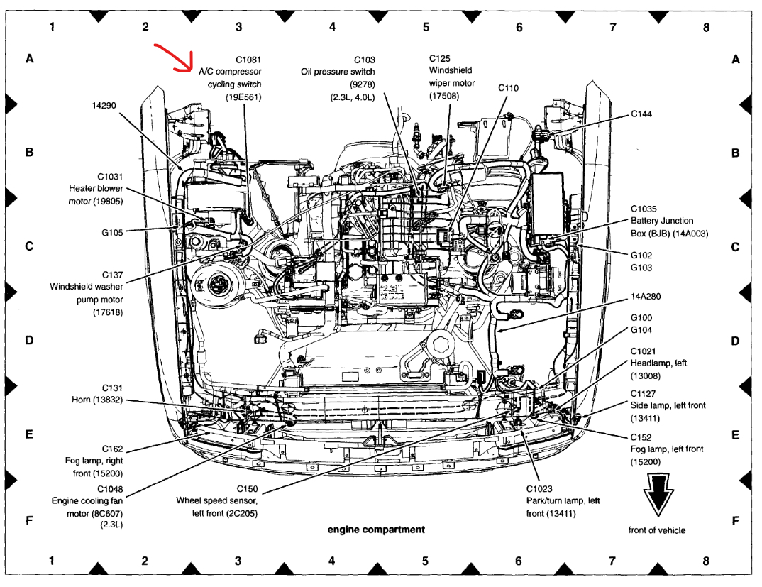

A/C not working, could it be bad wiring?
2004 FORD RANGER
200,000 MILES • 3.0L • V6 • AUTOMATIC
JOSUE RODRIGUEZ2
  • 23 POSTS
I believe it could be a bad wiring issue somewhere, but I unfortunately don't know how the system is wired. I checked out the relay and believe it's good, I think I might have a bad connection going to the relay as in the fuse box, but I don't know the exact wiring. Any help would be appreciated, thanks.
Sep 9, 2024 at 11:50 AM
  • 55,447 POSTS
Sure, I can help you fix it, I would start by turning the system on and then check for power at the compressor clutch feed wire wht/gry.
Here is a guide to help:
Also jump the low-pressure switch to see if the system comes on because you may be low on refrigerant. Please go over this guide as well:
There are a hand full of fuses that need to be checked as well, here are the A/C system wiring diagrams so you can see how the system works and which fuses to check. Check out the images (below). Please upload pictures or videos in your response of any problems so we can see what to help you with.
