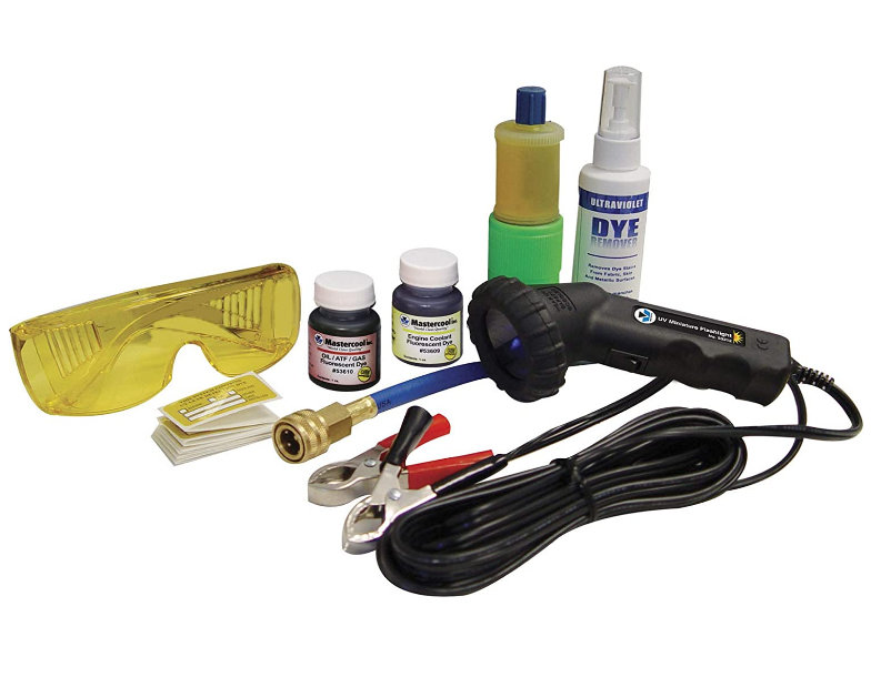

It sounds like there is a leak in the A/C system. The primary function of the caps for the A/C line is to keep our dirt and debris, so it is not likely the leak is from there, but it is possible to have a leaking shredder valve.
There are dyes that you can use on the A/C system, which can help you detect the leak.
Here is a helpful guide:
https://www.2carpros.com/articles/air-conditioner-leak-detection
