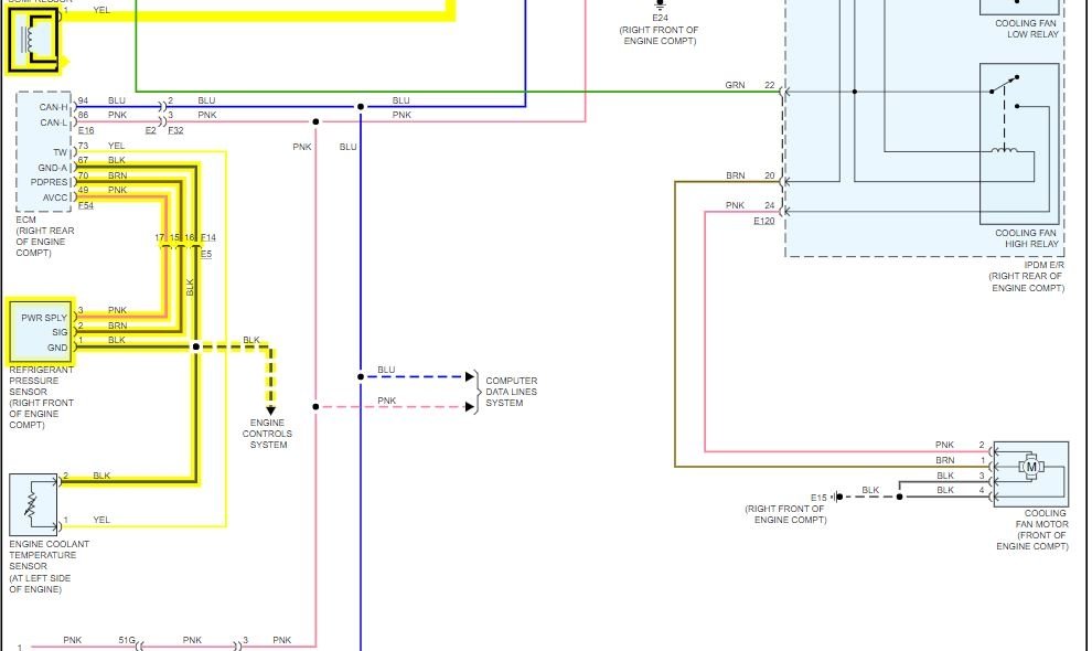

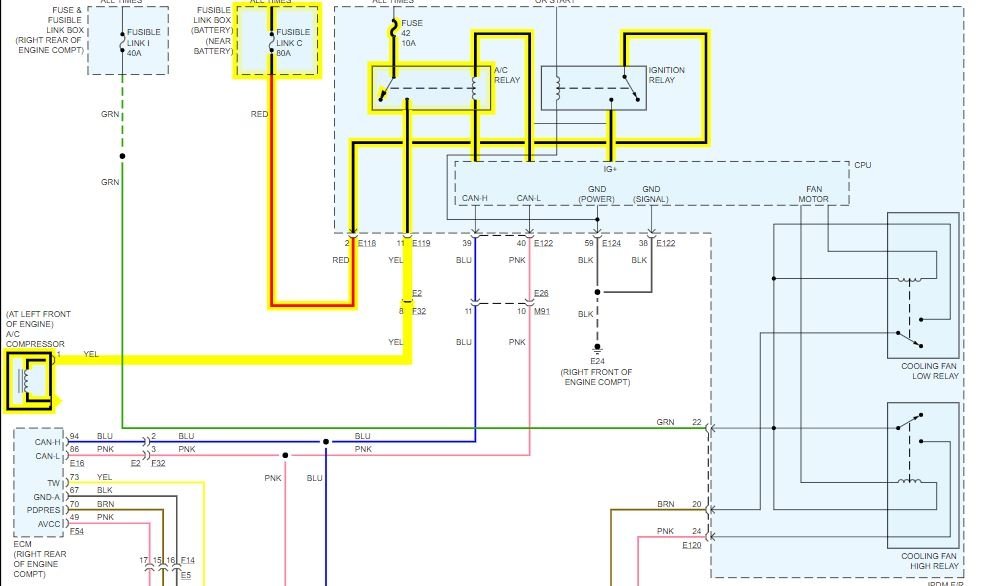

Can’t find the A/C relay. the A/C blows hot air and the air clutch is not catching.
Jul 2, 2020 at 10:41 AM
Good afternoon,
Did you check the freon pressures? If they are low, the compressor will not come on.
I attached a wiring diagram of the system for you. If you have a test light, we can do some voltage checks to see why the clutch is not engaging.
As far as the relay, it cannot be accessed. It is part of a module.
Note: The compressor relay or A/C relay is located in the IPDM (intelligent power distribution module) and is not serviceable.
