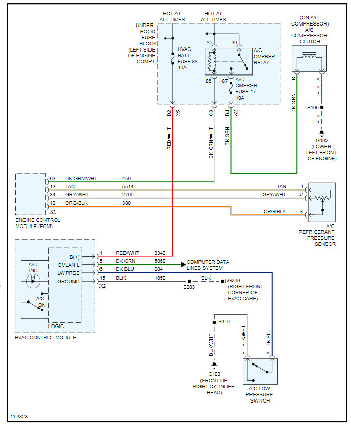

The problem I have now is the A/C compressor is not kicking on. The very next day it was no longer working. The lights just flashes and nothing happens then it stops flashing.
It worked before when the blower was not working. It literally stopped when the resister was replaced.
My husband then tried replacing the low pressure switch, jumped the low pressure compressor (it didn’t start) and it still won t work.
Any ideas?

When you say the A/C compressor will not kick in, you mean the compressor clutch will not engage? The compressor not coming on couple be a number of things like the low pressure switch that he jumped. If that didn't work then let's start with checking power at the compressor.
If you have power at the compressor when the A/C is on then the compressor is the issue.
If there is no power then we can start moving backwards in the system, starting with the relay. We will need to jump power to the compressor by removing the relay and jump power from 85 or 30 to 87. We can get to this if the power is not there.
Below is a wiring diagram that will help with this. Please let me know what questions you have.
