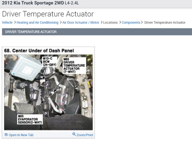

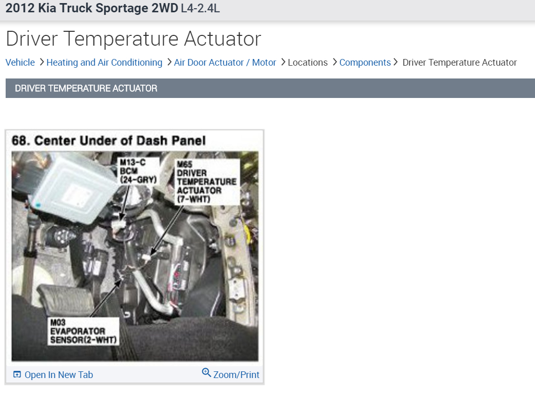

A.c. not working to refridgerant is full no leaks compressor and clutch are good all fuses and can are working but still won't cool
Jun 24, 2015 at 2:56 PM
MHPAUTOS
  • 31,937 POSTS
It sounds like you may have a blend door actuator that is not working correctly. This guide will help us see whats going on so we can get it fixed for you. Do you know the pressures?
Jun 24, 2015 at 9:19 PM
ATLAXCALA
  • 5 POSTS
I have filled it with a recharge a.c. machine from my brothers shop actually he filled it and the pressure is the same on both the high and low I believe it's 80 on both
Jun 24, 2015 at 9:24 PM
MHPAUTOS
  • 31,937 POSTS
If the pressures are equal on both sides the compressor has an internal leak and high pressure is bleeding into the low side.
Jun 24, 2015 at 10:11 PM
ATLAXCALA
  • 5 POSTS
The compressor has been changed it brand new
Jun 25, 2015 at 3:12 AM
MHPAUTOS
  • 31,937 POSTS
If the compressor is new, you may have a blocked TX (thermal expansion valve) did you replace the receiver dryer and was the comp changed due to an internal failure that may have deposited any debris in the system?
Jun 25, 2015 at 7:25 PM
ATLAXCALA
  • 5 POSTS
Expansion valve has been replaced and dryer compressor was replaced because we thought it had an internal leak but it didn't
Jun 26, 2015 at 2:32 AM
MHPAUTOS
  • 31,937 POSTS
Sounds as if you have a blend door actuator that is not working here is the location so you can check it out. Check out the diagrams (Below). Please let us know what happens.
Jun 26, 2015 at 10:26 AM
ATLAXCALA
  • 5 POSTS
I didn't even notice the passengers side was cold so the system is working I got a new actuator and installed it now it works like it should that s for helping me with this.
Jun 26, 2015 at 4:52 PM
MHPAUTOS
  • 31,937 POSTS
Glad you could get it fixed, that kind of problem can be tough. Please use 2CarPros anytime we are here to help.

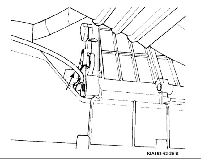

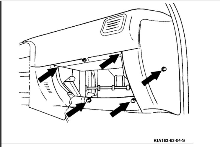

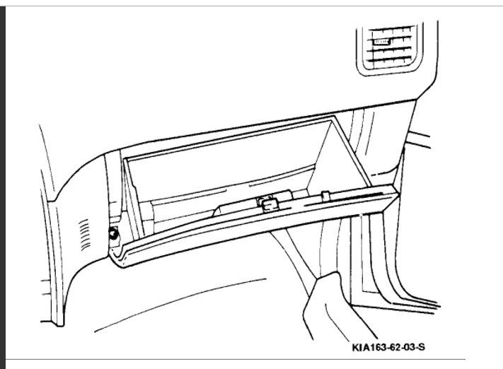

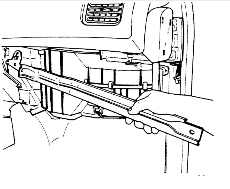

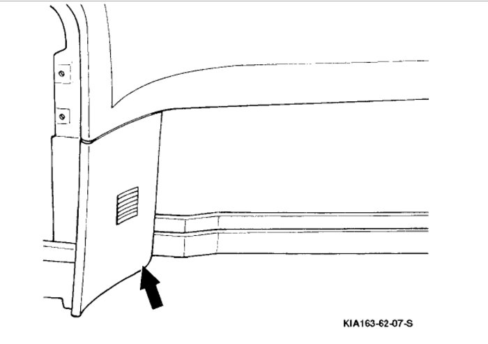

I don't think it is a pressure switch issue, it sounds more like a temperature blend door actuator has gone bad.
Here is a guide that will show you what you are in for when changing the actuator out.
Here is the way to gain access (below)
If it is a manual system see if the cable has fallen off.
This guide should help as well
