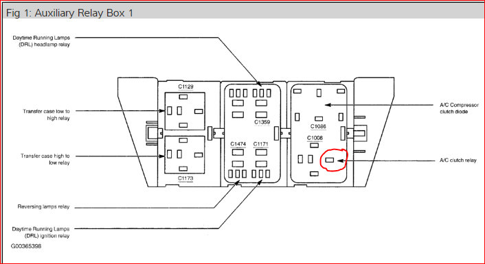

diagram to where the AC relay?
2005 LINCOLN NAVIGATOR
200,000 MILES • 0.8L • V8 • 2WD • AUTOMATIC
DEDI REDMOND
Need a diagram to where the AC relay is or the exact relay to check or change.
Jul 10, 2018 at 7:50 AM
DANNY L
  • 5,648 POSTS
Hello, I am Danny.
I am attaching a picture of the relay location (circled in red) and also attaching a link on how to test. It is under-hood in the auxiliary relay box. Hope this helps and feel free to ask any questions if needed. Thanks for using 2CarPros.
