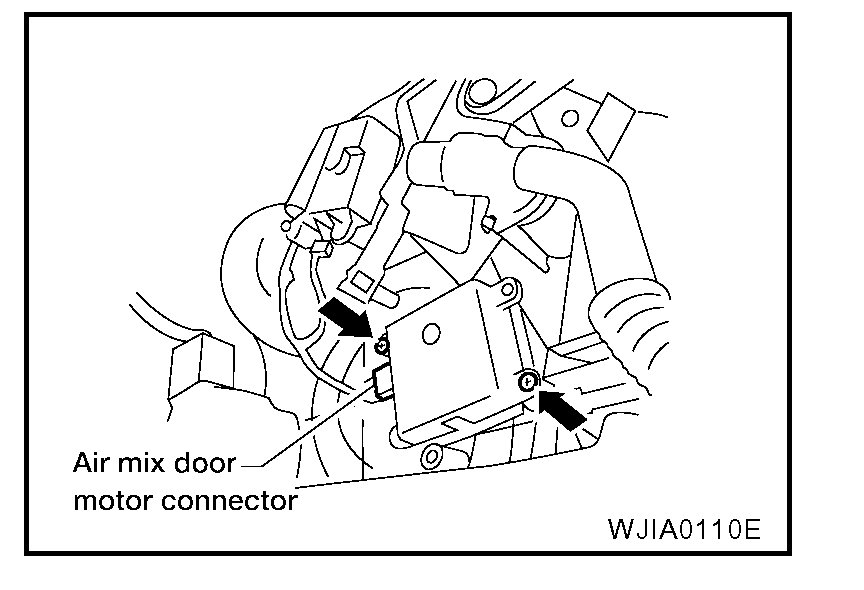

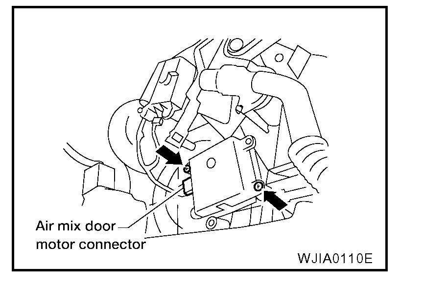

If the compressor is working, have you checked the blend air door for operation? Take a look through these links.
Here are the directions for replacement of the actuator. It may not be working and would cause a problem.
2003 Nissan-Datsun Altima L4-2.5L (QR25DE)
Air Mix Door Motor
Vehicle Heating and Air Conditioning Air Door Actuator / Motor Service and Repair Procedures Automatic Air Conditioner Air Mix Door Motor
AIR MIX DOOR MOTOR
pic 1
Removal and Installation
1. Remove the driver lower instrument panel assembly. Refer to "Driver Lower Instrument Panel".
2. Disconnect the air mix door motor connector.
3. Remove the air mix door motor screws and then remove it.
