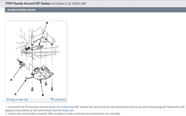

I replaced the climate control module because it wasn't working and now it blows, and all of the A/C lights come on, but the air is still hot. I have recharged the system and checked the clutch on the compressor, and it is working. Any idea what is wrong? Anything is helpful. thank you.
Jul 10, 2022 at 7:47 AM
  • 110,244 POSTS

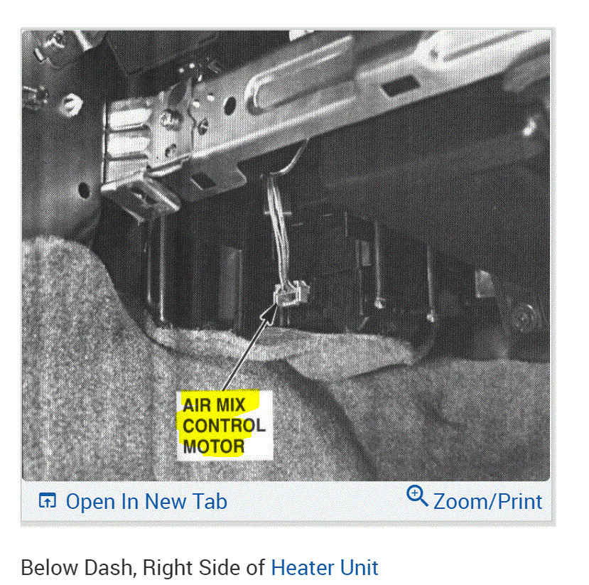

If the A/C is charged and the clutch is engaging, the next thing to check would be the blend air door actuator. The blend door is what is responsible for the air temperature entering the vehicle.
One simple test would be to see if the heater works. The same door provides heat in one direction and A/C in the opposite.
Even if the heater does work, I would recommend removing the actuator motor and seeing if it will respond when you change to the A/C setting.

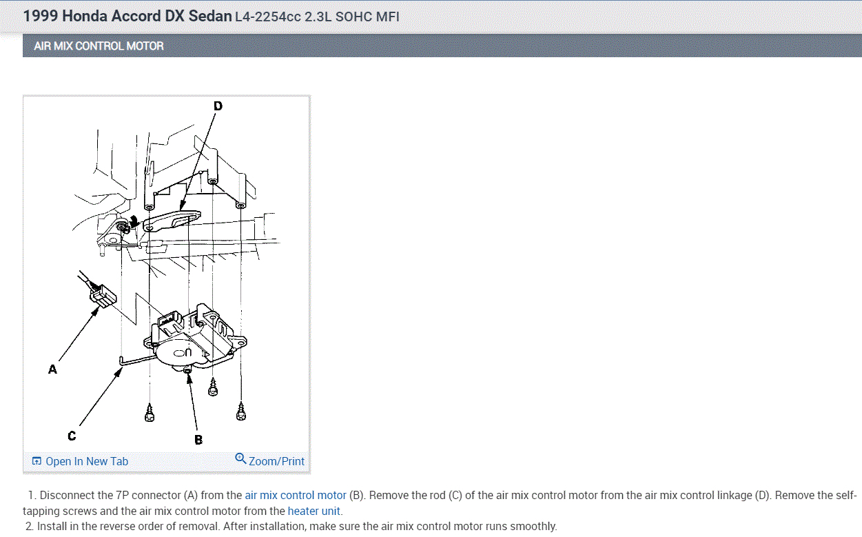

If you look at pic 1 below, it shows the location of the actuator. Pic 2 are the directions for replacement. Additionally, here is a link you may find helpful:
Let me know if this helps or if you have other questions. Note: The pics below are specific to your vehicle.
