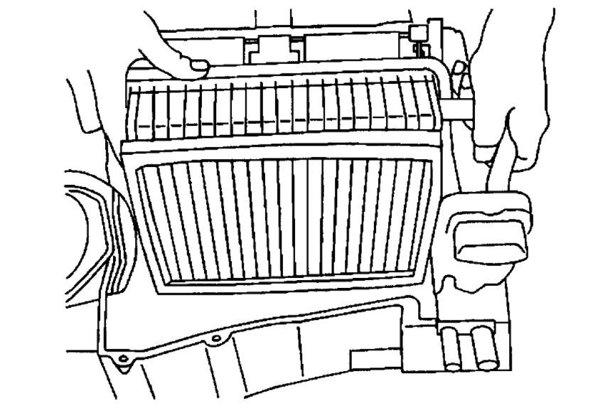

I attached the replacement for the evaporator once you remove the heater box from the video I posted.
Make sure you add 2 ounces of Pag oil to the core before installing it.

1. Remove the HVAC module assembly. See: Housing Assembly HVAC > Service and Repair

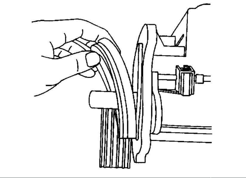

2. Remove the seal from around the heater core and the evaporator tubes.
3. Remove the upper A/C evaporator case.
4. Remove the evaporator core.

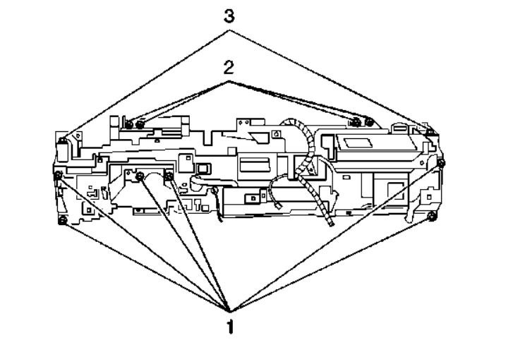

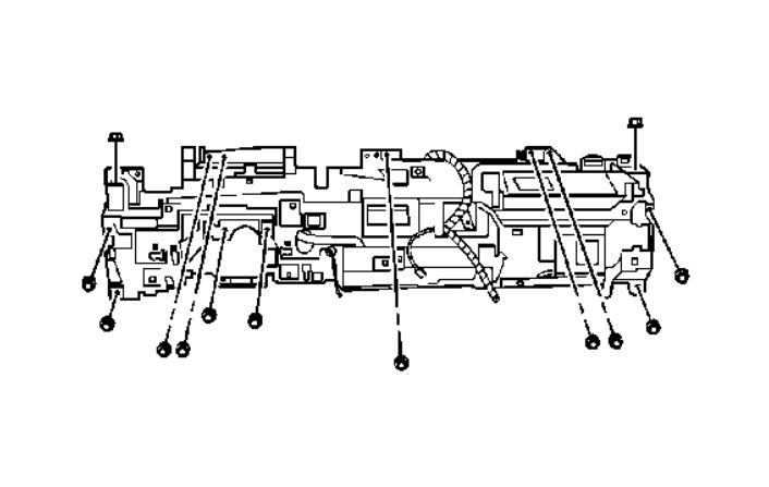

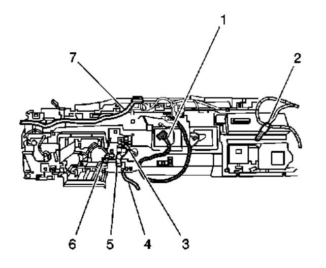

Okay, I attached the procedure for removing the dash panel to access the heater case that holds the evaporator assembly.
Instrument Panel Carrier Replacement
Removal Procedure
1. Remove the IP retainer.
2. Remove the data link connector fasteners.
3. Remove the passenger inflator module.
4. Disconnect the ignition switch electrical connectors.
5. Remove the shift/park lock cable from the ignition switch.

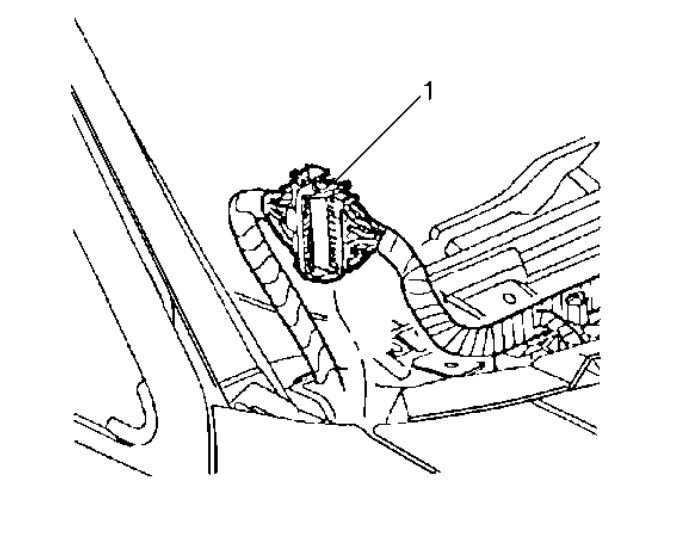

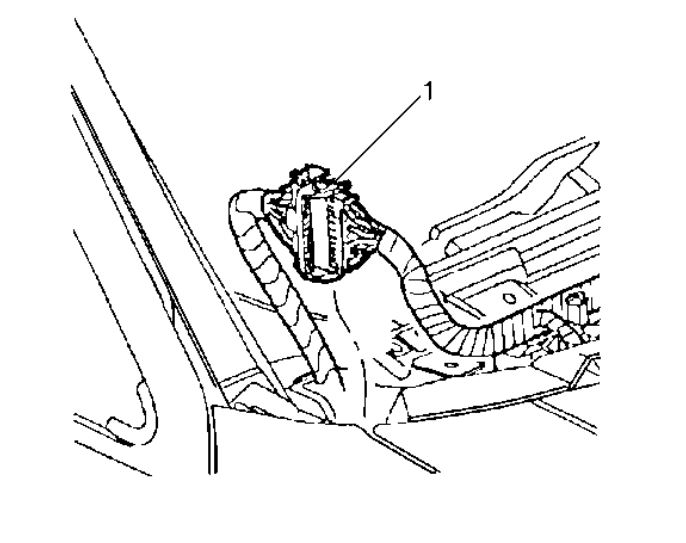

6. Disconnect the body to IP electrical connectors (1) located at the upper right outside corner of the IP carrier.

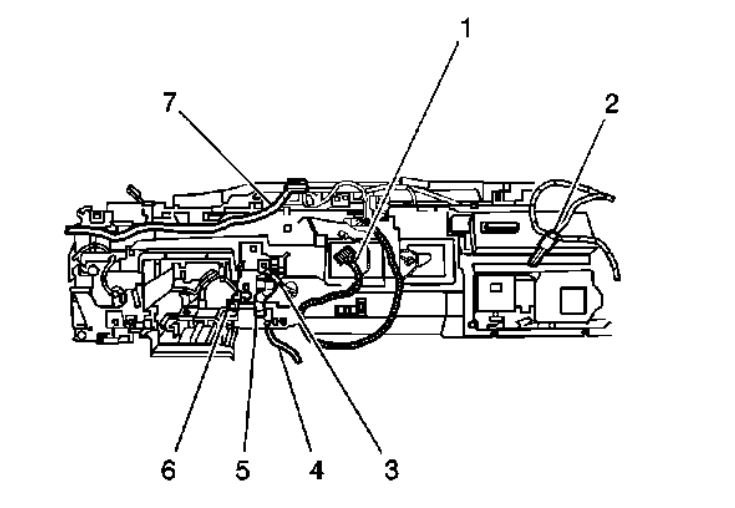

7. Remove the HVAC aspirator tube (5).
8. Feed the ignition switch wiring (4) through the IP carrier.
9. Feed the shift/park lock cable (3) through the IP carrier.
10. Feed the console wiring harness (1) through the IP carrier.
11. Release the SIR harness (6) retainer from the IP carrier.
12. Remove the IP carrier fasteners.
13. Remove the IP carrier from the vehicle.

7. Install the fasteners (1) from the IP carrier to hinge pillar.
Tighten the IP carrier fasteners (1) to 25 N.m (18 lb ft).
8. Install the IP carrier to cowl fasteners (2).
Tighten the carrier to cowl fasteners (2) to 25 N.m (18 lb ft).
9. Install the IP carrier to end bracket fasteners (3).
Tighten the carrier to end bracket fasteners (3) to 25 N.m (18 lb ft).
