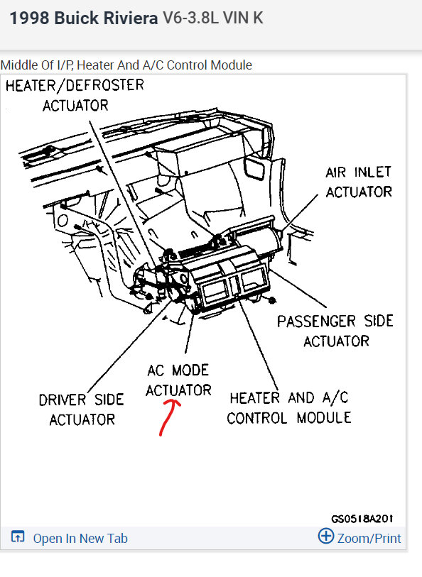

I press the button to turn on the A/C and nothing happens at all. The buttons on the climate control are all lit up and the small screen shows numbers as well. But no air comes out at all, hot or cold. The compressor does turn on, and the refrigerant pipe feels really cold to the touch. I already checked the corresponding fuses and the compressor relay and they're all good. I bought another climate control unit just to rule that out, but still no change at all. Any info is appreciated.
Aug 24, 2024 at 5:39 AM
  • 55,694 POSTS
Can you hear the blower motor running when the system is on? If not, you could have a bad blower motor and if so, it sounds like the mode actuator is not working?
This guide can help:
https://www.2carpros.com/articles/low-or-no-air-flow-from-vents

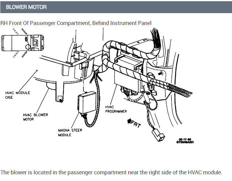

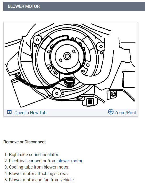

Here is how to test the blower motor wiring and I have included the blower motor and mode actuator location so you can check it out.
https://www.2carpros.com/articles/how-to-test-an-automotive-hvac-system-blower-fan-motor-a-detailed

The blower resistor only comes into play on the lower speeds. Does the fan motor work at high speed? If not, I would use the guide above and if you have power and ground replace the blower motor again.

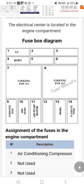

Another thing I was curious about is this fuse box located under the hood in my 1998 Riviera. There's 2 relays labeled Cooling Fan #2 and Cooling Fan #3. Below those there's one labeled just Cooling Fan.
I assume Fans #2 and #3 mean the radiator fans, but what about the one just labeled Cooling Fan, could that be for the A/C blower?

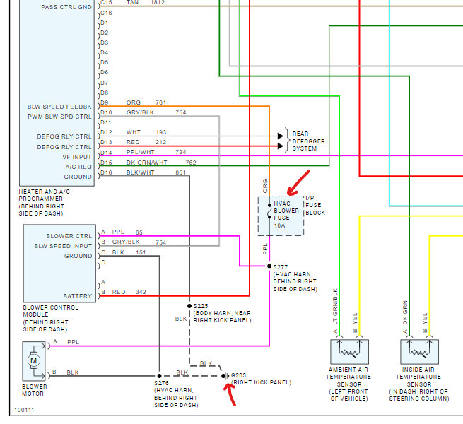

You can check the ground by using this guide with the test light connected to power.

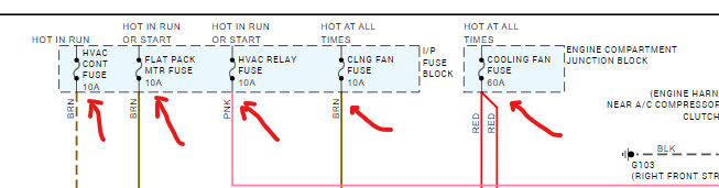

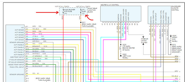

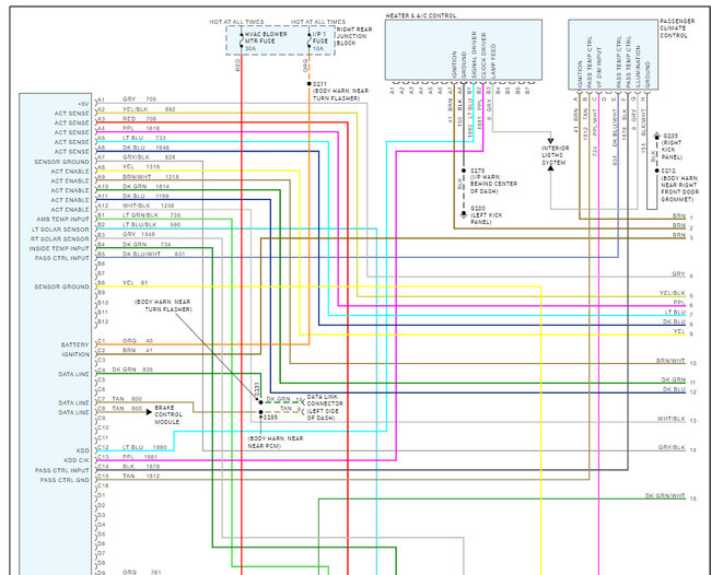

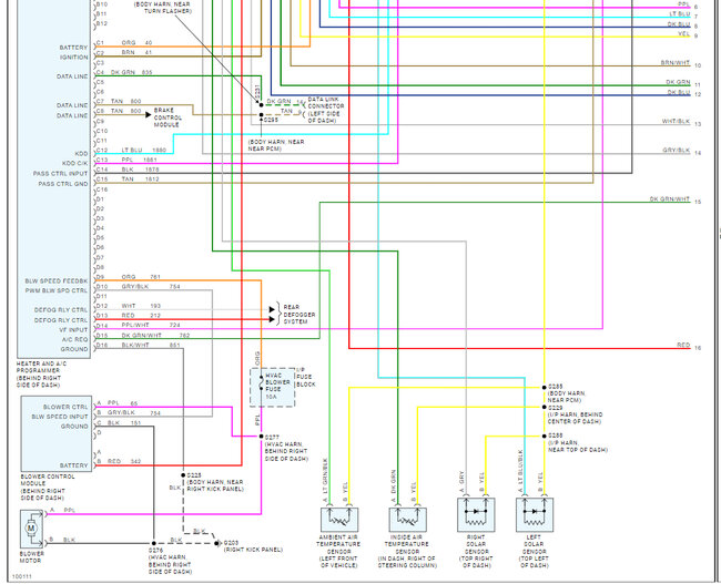

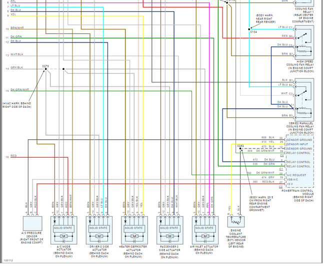

I would also check the HVAC blower motor fuse and the IP 1 fuse in the right rear fuse panel. I have also included the other five fuses that run the system in the images below that need to be checked as well and their locations.

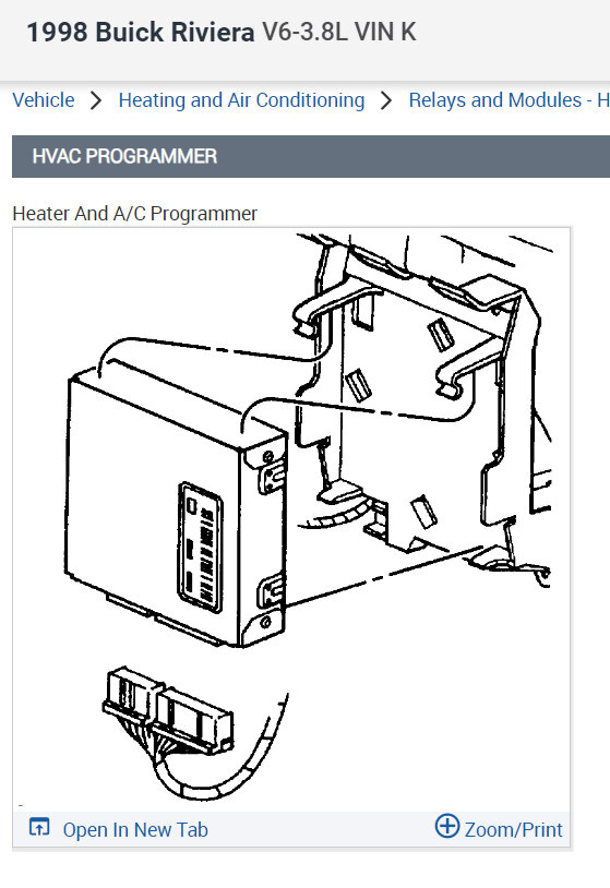

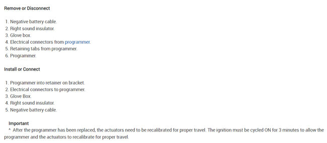

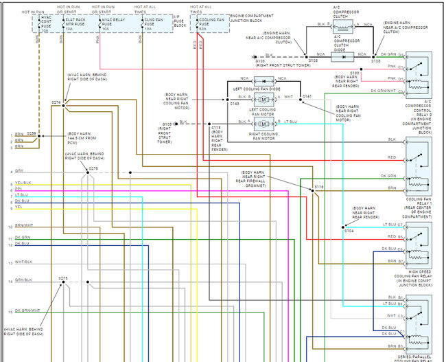

If all fuses are good and the ground is good, I would replace the Heater and AC programmer behind the right side of the dash. I also included the complete HVAC wiring diagrams. Check out the images (below). Please let us know what happens.

Okay, so, I checked the HVAC Blower Motor fuse (30a) and the IP fuses 1 and 2 (10a) and they're all good. Also, I should mention that I bypassed the heater core a long time ago. Since there's no coolant running through it, I don't have heat, which is fine because it's hot basically all year round where I live. I will look again into testing for ground and current at the connector.
Is there a way to test the resistor? Someone told me that a bad resistor can also cause for there to be no air from the vents. Thanks
