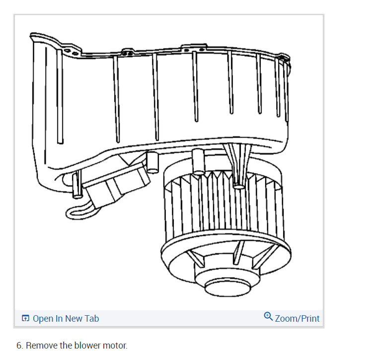

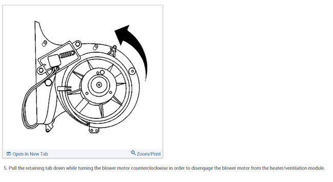

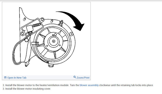

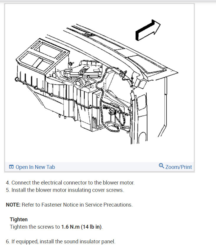

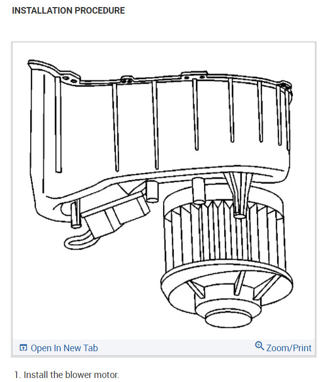

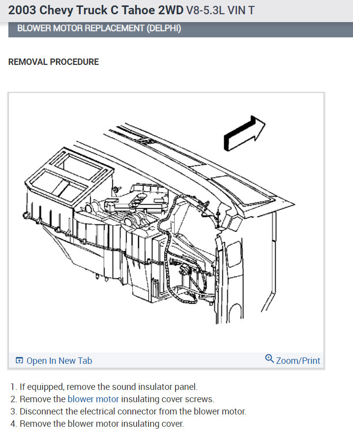

When I turn on the car and I drive and turn on the cold air it doesn't blow just throws cold air. I think it's the blower. what do you think?
Jun 23, 2021 at 7:48 AM
  • 55,746 POSTS
It sounds like the blower motor is no good. to be sure this guide will help you check the power and ground and I have included the blower motor location and replacement instructions:
https://www.2carpros.com/articles/blower-fan-motor-works-on-high-speed-only
