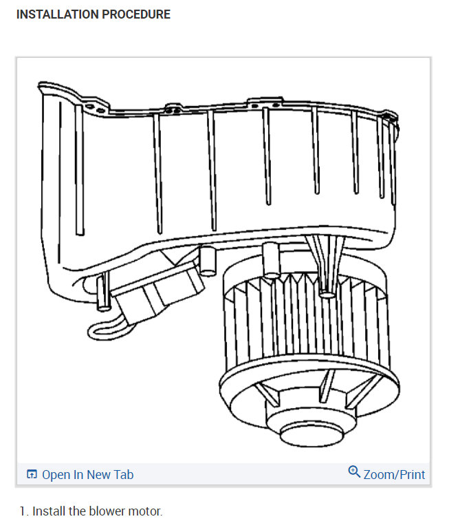

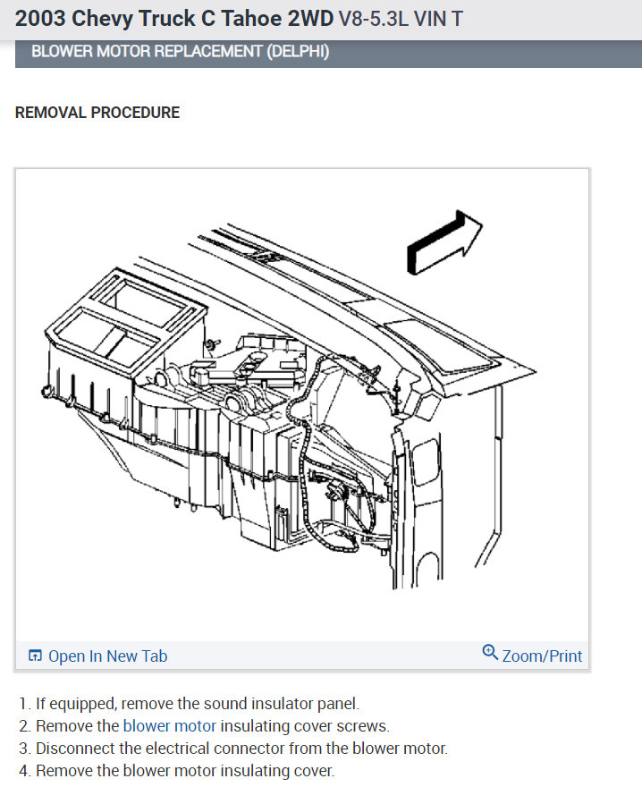

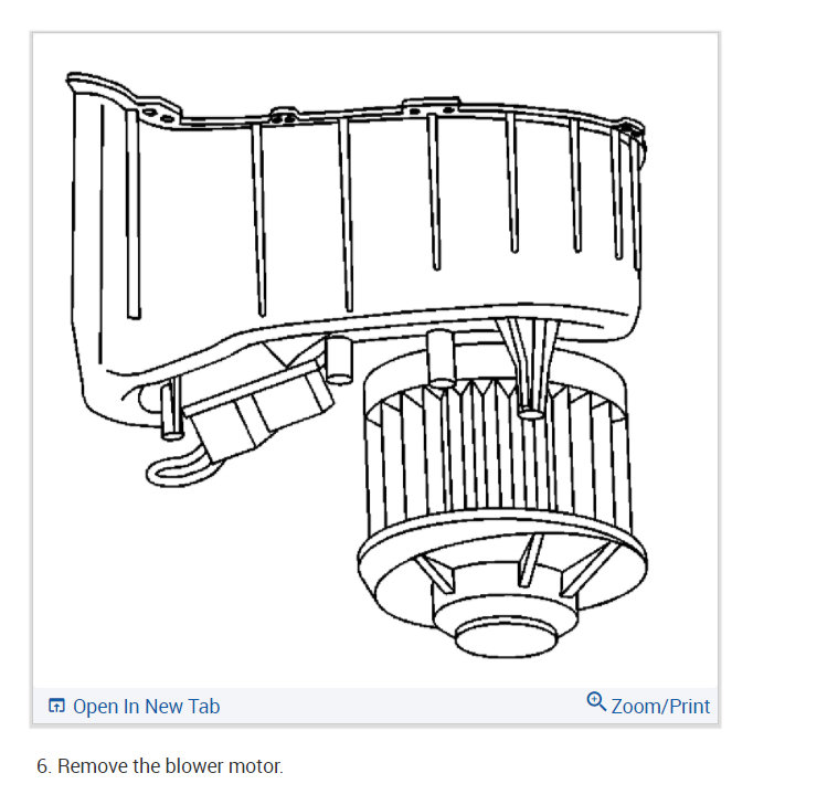

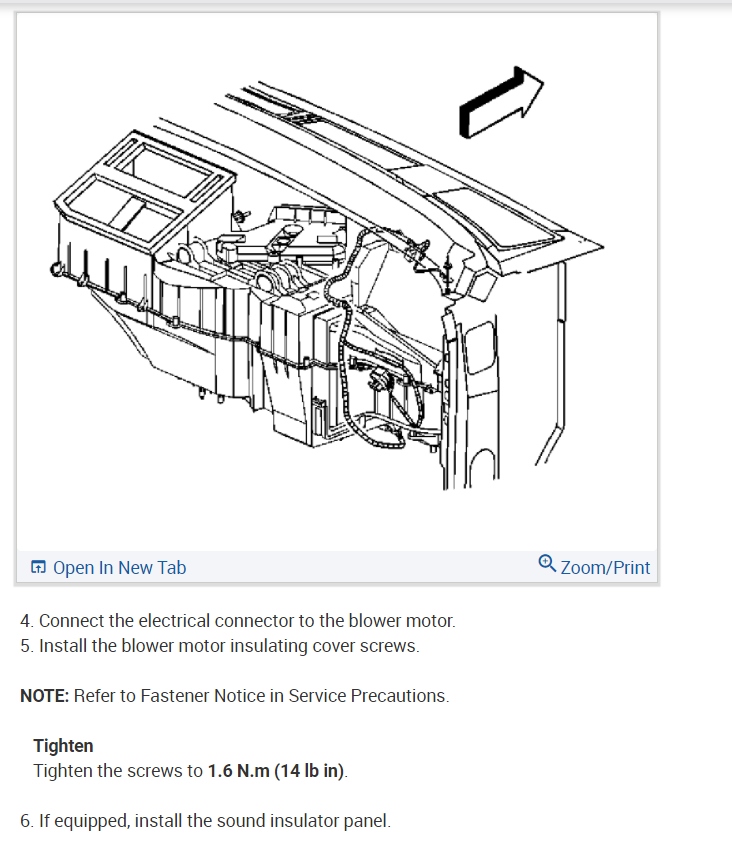

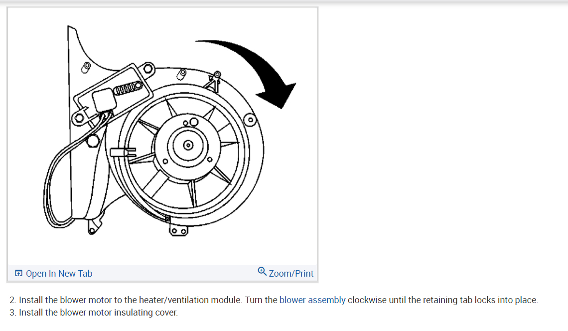

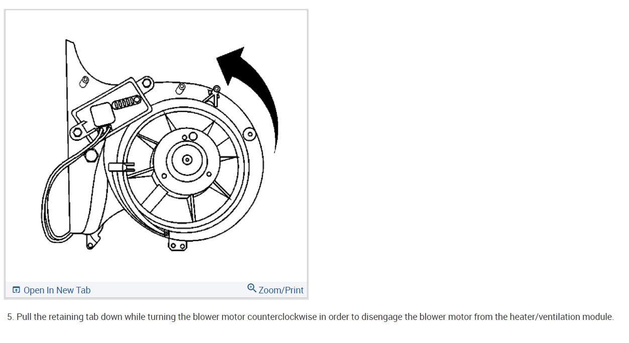

It sounds like the blower motor is no good. to be sure this guide will help you check the power and ground and I have included the blower motor location and replacement instructions:
https://www.2carpros.com/articles/blower-fan-motor-works-on-high-speed-only
