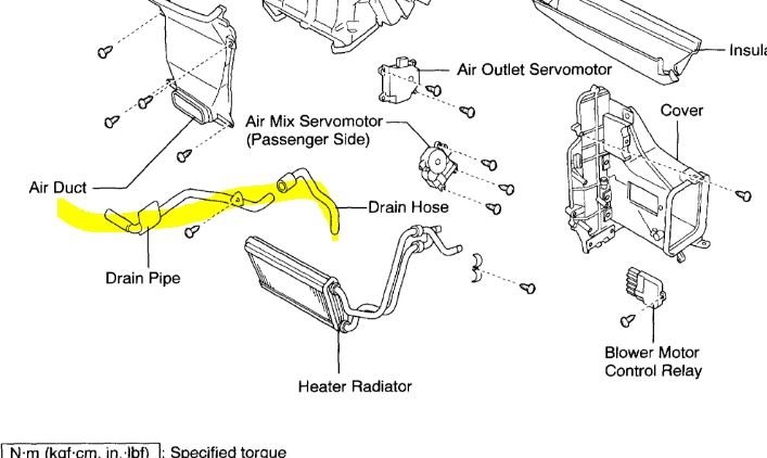

A/C was working, but water is leaking on the passenger floor.Then it stopped blowing for a week,then started back working,but still was leaking water. Two weeks later stopped working completely. Doesn't blow at all.What is wrong?

If you are getting water on the floor, there is a drain tube that is most likely plugged. It is under the hood on the passenger side of the firewall. See if there is dirt blocking it.
When you say you have no A/C at all, do you mean the blower motor stopped working?
