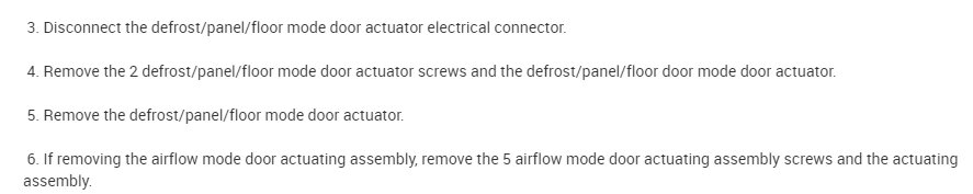

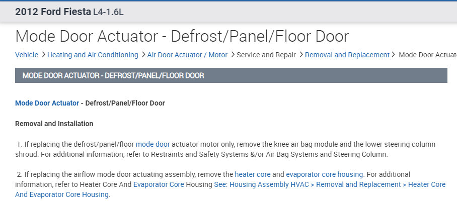

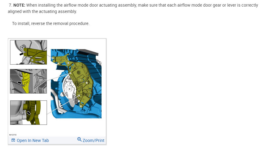

What I suggest is to remove the mode door actuator and see if it responds when you change the airflow direction. I suspect the door is moving from calibration and trying to distribute airflow in all directions. That's a theory, but in my mind, it makes sense.
The next time it happens, see if it seems like air is coming in multiple directions. If it is, then replace the actuator.
I attached the directions below.
