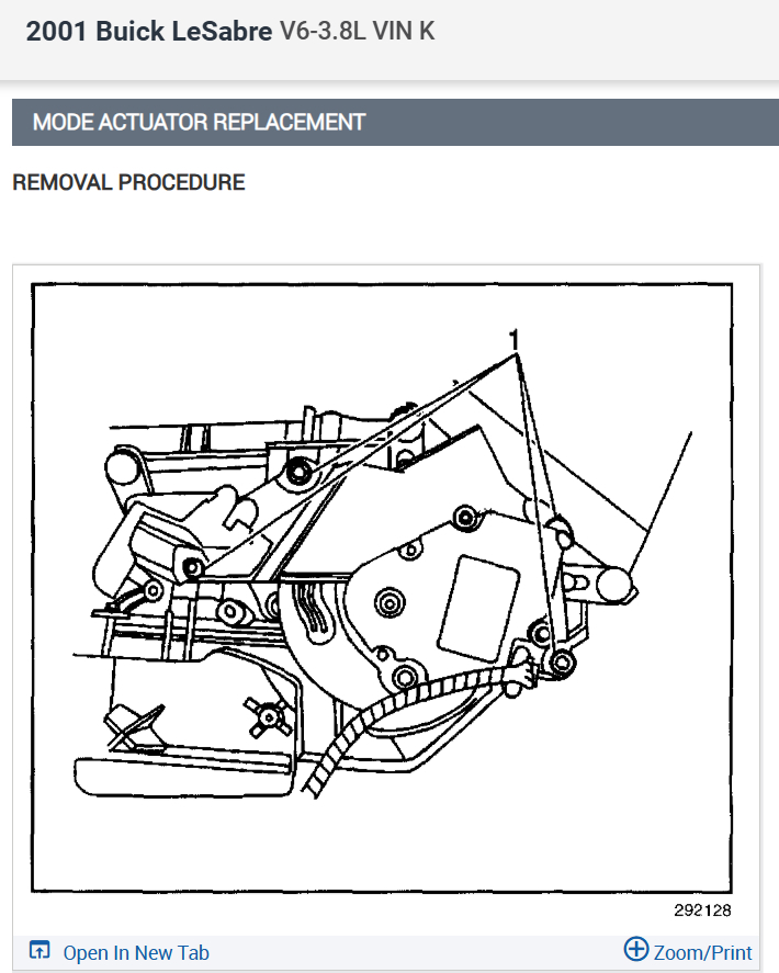

AC mode door is stuck on defrost/floor?
180,000 MILES • 3.8L • AUTOMATIC
JOET2112
How to remove the AC mode door?
Sep 26, 2026 at 4:56 PM
  • 55,694 POSTS
The mode actuator is mounted on the HVAC case under the instrument panel. Before attempting to remove the door, remove the lower dash/insulator panels and watch the actuator while changing the HVAC setting from PANEL to FLOOR to DEFROST. If the actuator doesn't move, disconnect it and see whether the mode-door shaft can be moved manually.
