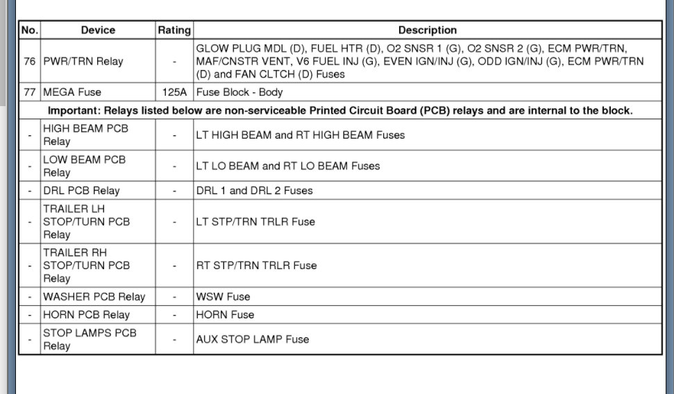

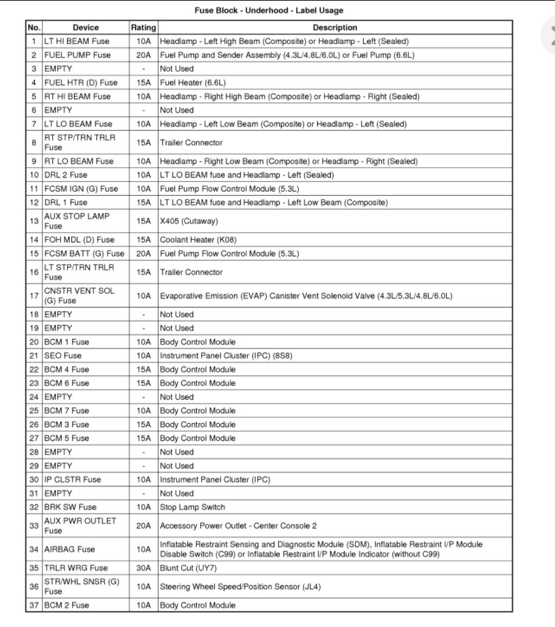

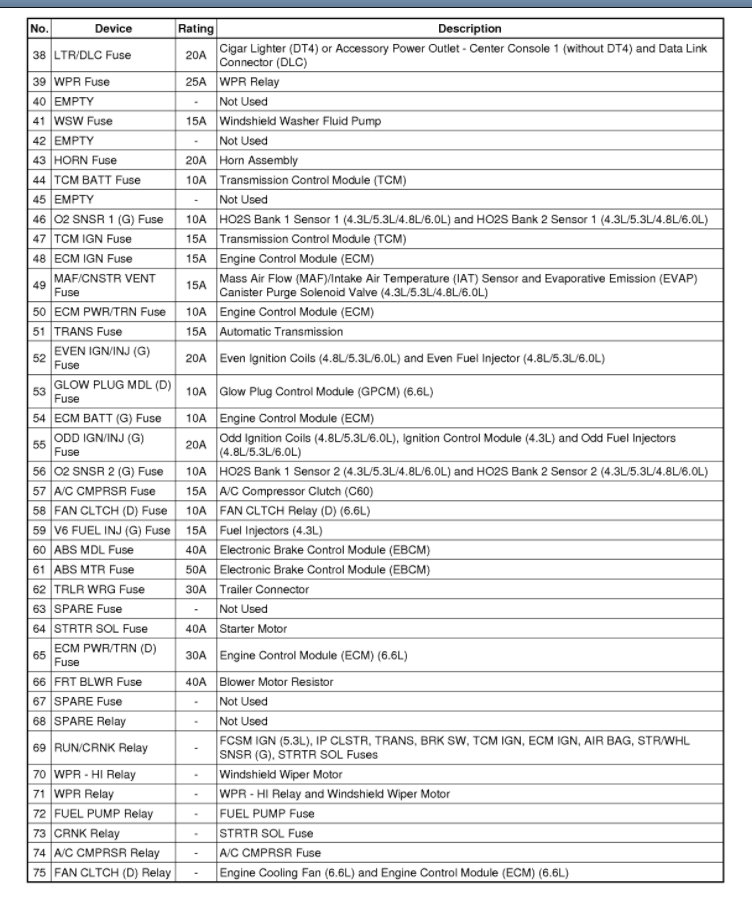

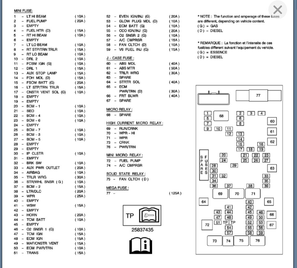

Where is the fuse panel I need to check them? The mode blend door is not working.
Saturday, August 19th, 2017 AT 11:58 AM
MECHANIC
18,907 POSTS
Here is a guide that will help with testing and replacing the fuses. Please run through this and let me know if you have questions.
Below is a copy of the fuse layout. Thanks for using 2CarPros.
