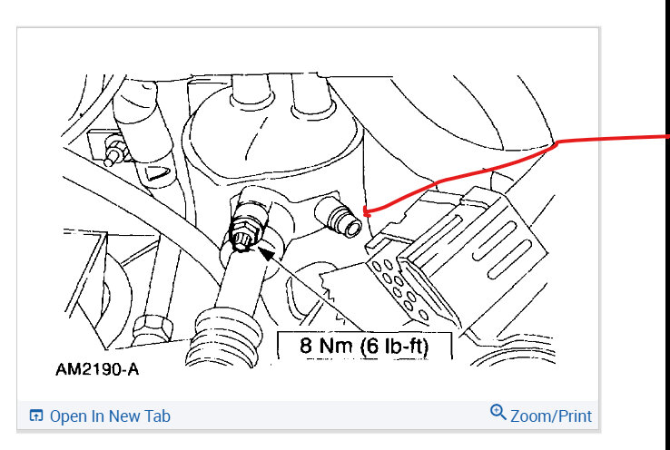

It has been a hot summer here, so my car A/C hasn't been working well. I need the front and rear A/C in my Navigator to be running for me to feel any cold. In the morning, when the sun has not been on for a while, I can get some cold. However, when I drive in the afternoon after the car has been sitting in the sun for a while, the car doesn't get cold even after I have been driving for a while with the front and rear A/C on.
So, I decided to extract whatever little refrigerant is left in the car and recharge it myself. The problem is the service port for the low-pressure side is horizontal and in a very tight area. I am using a four-way manifold set to extract. When I tried to attach the coupler at the end of the low-pressure hose, there wasn't enough space for me to attach the coupler to the service port even though the coupler is only 1.75 inches. Is there a way to find a coupler smaller than this?

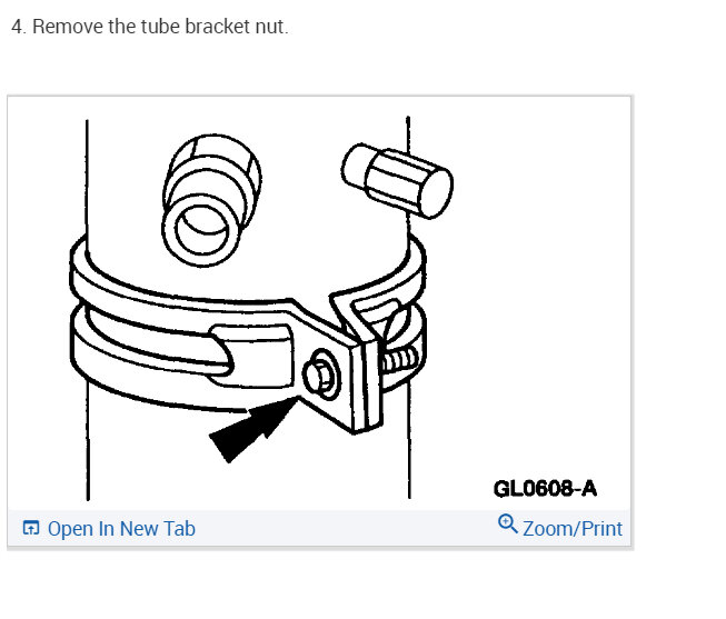

The low side charge port is on the accumulator, I am not sure of the port you are finding. Can you upload an image? Check out the images (below). Please let us know what happens.
Aug 22, 2023 at 6:11 AM
MOO2CAR
  • 59 POSTS
Thank you for your reply. Yes, that is the service port that I have been trying to attach the coupler to. I attach the video below showing the service port without coupler (first 2s) and with the coupler (last 2s) at the end of the blue hose. The problem is that the space beyond the service port is so small that I am unable to line up the quick coupler well and clip it onto the service port. My question is that where can I find a coupler that is small enough to fix it to the service port. Is there a different type of coupler to attach the hose to the service port?

It looks like there is room for the service connector?
Aug 28, 2023 at 2:58 AM
MOO2CAR
  • 59 POSTS
For some reason, the connectors that I bought do not fit because of the small space. I thought the quick connect I am using which is only 1.75 inches long is too long. There is one object on the other side of the service port that is not letting the quick connect fit horizontally so I can then push it onto the service port.
Aug 28, 2023 at 3:09 PM
  • 55,423 POSTS
Can you move the item that is obstructing you from doing the job? If not you will need to get a shorter service coupler.

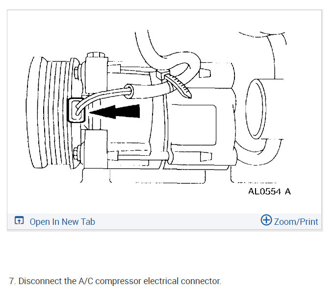

Driving it will not help, and AC compressor is down low on the passenger side of the engine. Here is a guide to help you, please go over it.
When you turn the ac system on you should be able to see and hear the clutch kick on. Please check the image below to show you the location of the compressor. Check out the images (below). Please upload pictures or videos in your response of any problems so we can see what to help you with.
