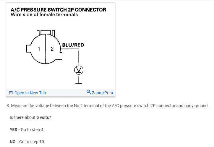

Upon recharging my A/C system I found out that the line at the evaporator is freezing up where the expansion valve is at the compressor is always engaged, but I’m able to turn it off and on with the A/C button inside the car. I will add some pictures below so you can see what I am talking about, but I am thinking it’s maybe the expansion valve not to sure though.
Aug 4, 2022 at 5:29 AM
  • 110,240 POSTS

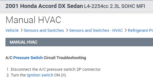

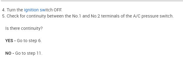

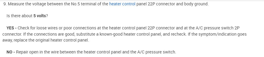

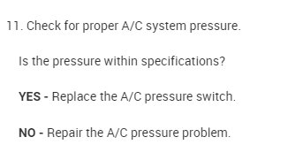

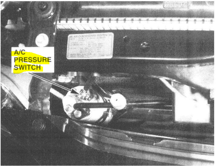

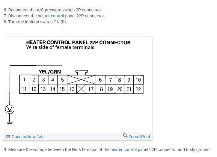

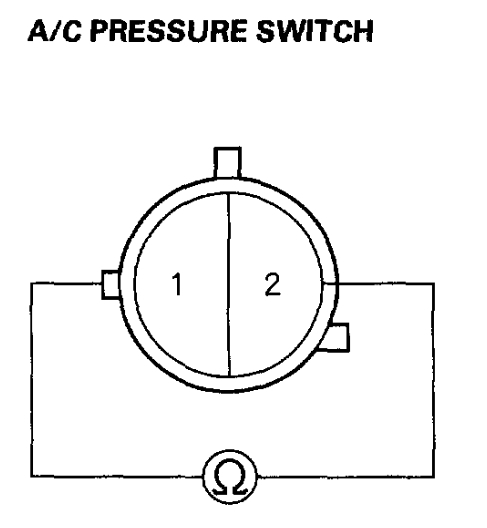

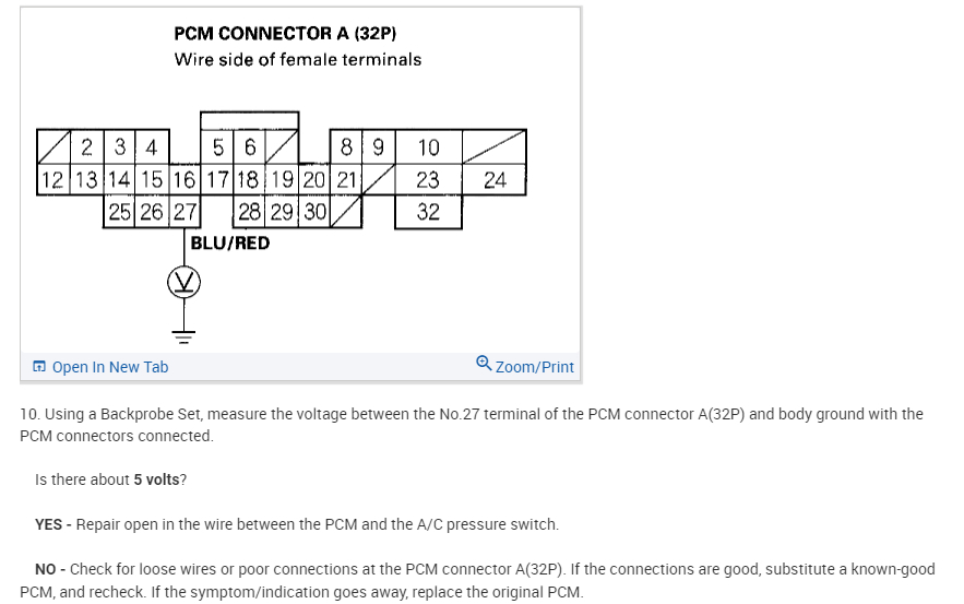

If the system never turns off, it sounds like the AC pressure switch isn't doing its job. The switch is located in the condenser outlet (passenger side behind bumper cover). I attached a pic below showing the location.
The pressure switch is what will cycle the compressor. What I need you to do is check the switch to see if it is good.
Starting with pic 2 are the directions for testing it. Try this and let me know the results.

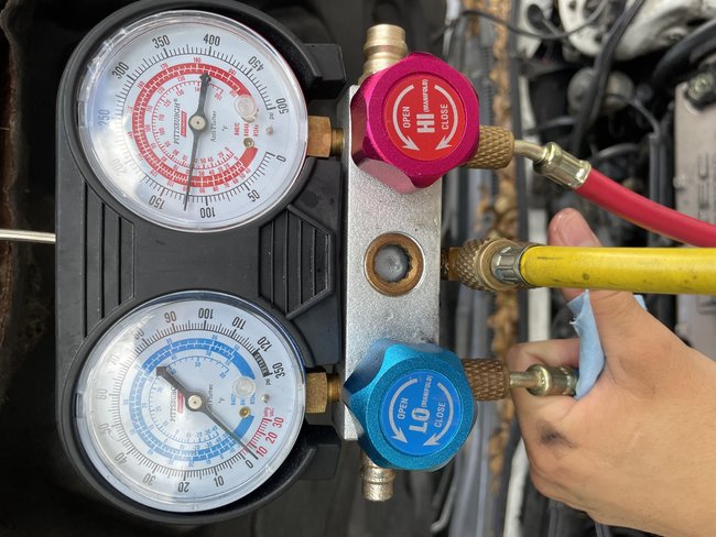

Okay, the only other thing I can think of is if the refrigerant is a bit low. By chance, do you know both the high and low-pressure readings? If so, let me know what they are and what the outside temperature was when checked.
Aug 11, 2022 at 11:32 AM
TONY02
  • 86 POSTS
When I have the switch off for the A/C inside the car The low pressure is 75 and the high-pressure side is 125 with the outside the temperature being 89°F and when I have the switch on the low-pressure side is 25 and the high-pressure side is still 125 with the outside temperature being 89°F. I’m starting to think it can be a bad compressor maybe because I don’t feel refrigerant flowing through the lines.
Aug 17, 2022 at 12:38 AM
  • 110,240 POSTS
With the vehicle off, the pressure should equalize. It may take some time. However, what you listed with it off doesn't make sense.
With the system on, the readings you listed indicate low Freon.

So, I replaced the compressor and fully recharged it but now the pressure is reading really weird low-pressure side is in vacuum and high-pressure side is around 125.
Aug 21, 2022 at 3:34 AM
TONY02
  • 86 POSTS
I already replaced the evaporator core with the expansion valve.
Aug 21, 2022 at 3:43 AM
TONY02
  • 86 POSTS
I ended up replacing the accumulator and condenser as well but I’m still getting the same thing the low side is going into a vacuum.
Aug 21, 2022 at 6:48 AM
  • 110,240 POSTS
Are you absolutely certain there is enough freon in the system? This happens when freon is low. it's got nothing to compress so it goes into a vacuum. That is the only thing I can think of.
