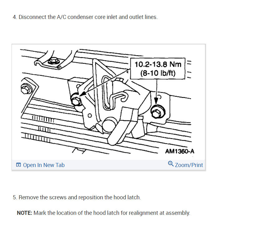

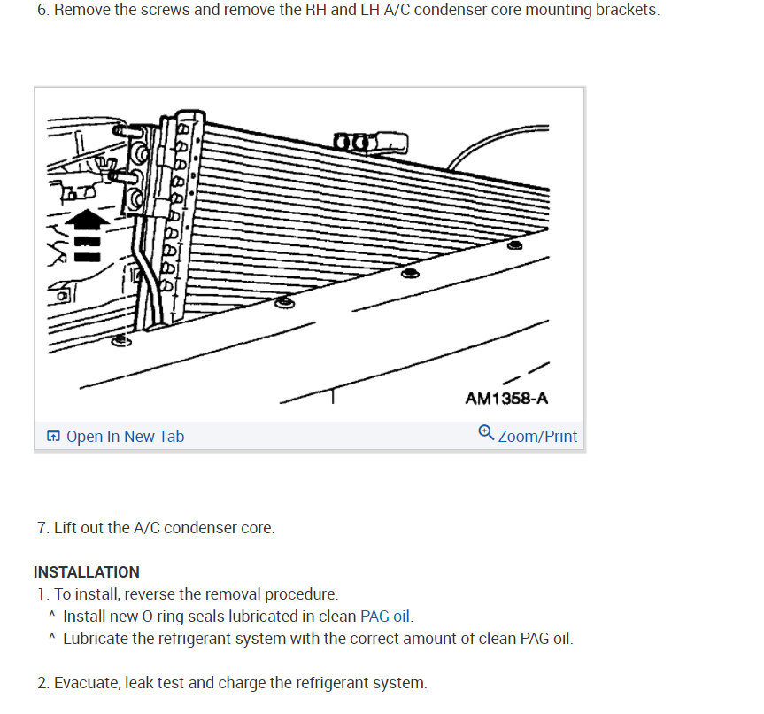

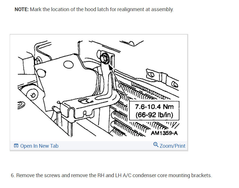

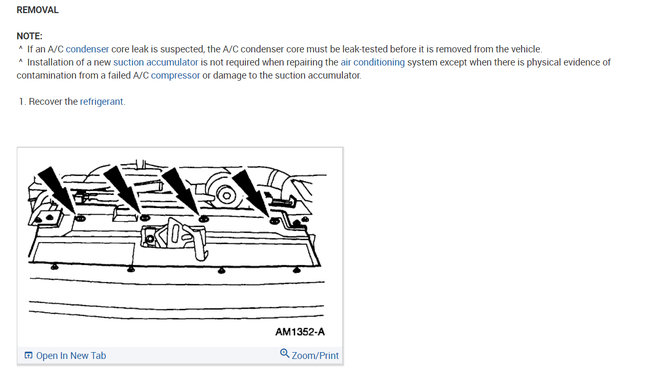

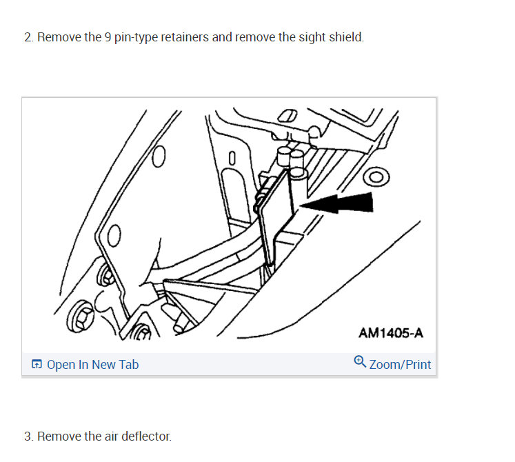

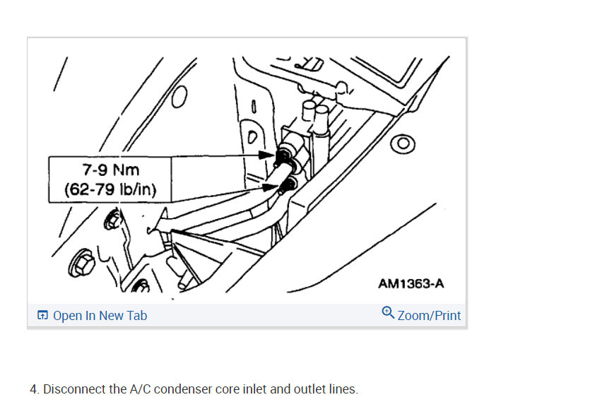

Common areas are the condenser itself from debris picked up from the road.
https://www.2carpros.com/articles/air-conditioner-leak-detection
You can inject a dye and use a bright LED flashlight to find the leak.
