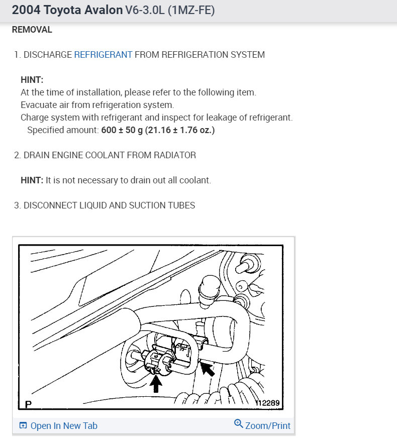

I was told I have a leak in my A/C coil and an estimate of $1,600. I have researched and everything I found says no repair. So, I wanted to know where it's located and if I could do a DIY. I have a problem with the actuator on the driver side that I have already taken off and manually temporarily fixed until I get new one.

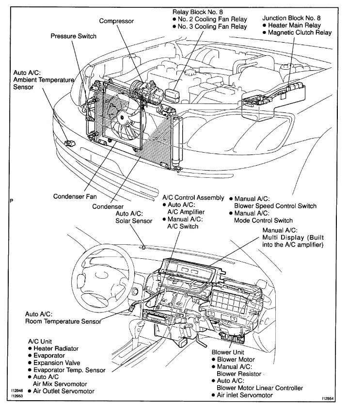

When you say A/C coil do you mean the evaporator or the condenser? Please check out the images below for clarification.

Is the part in the front of the car or inside the passenger compartment?
May 23, 2023 at 3:35 AM
JJONES72
They said inside. Said the whole dash would have to come out to replace it. I didn't know whether they were just trying make me think it was a big job because they quoted me $1,600.00.

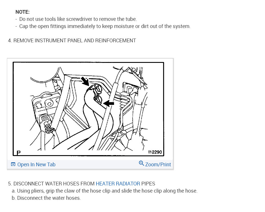

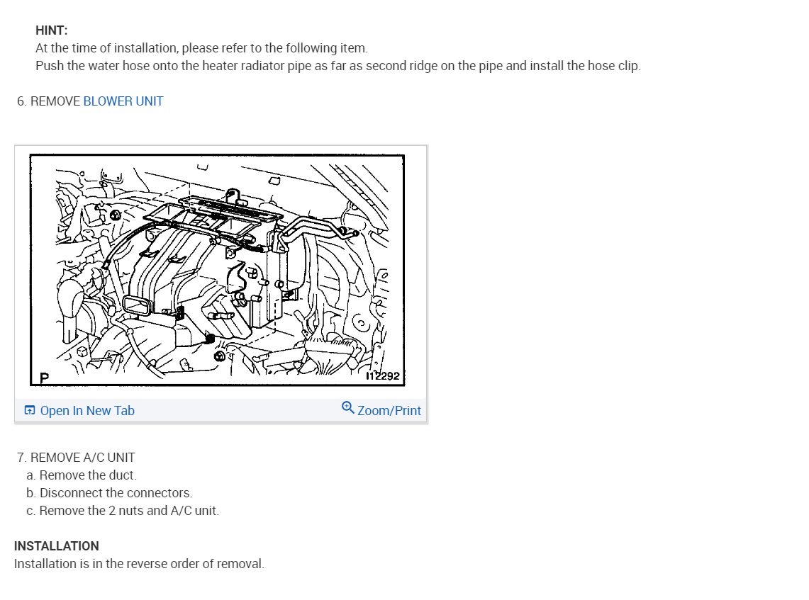

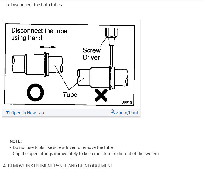

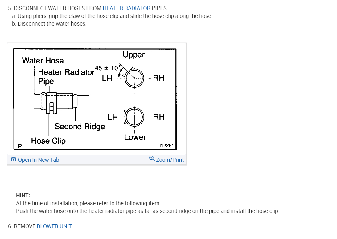

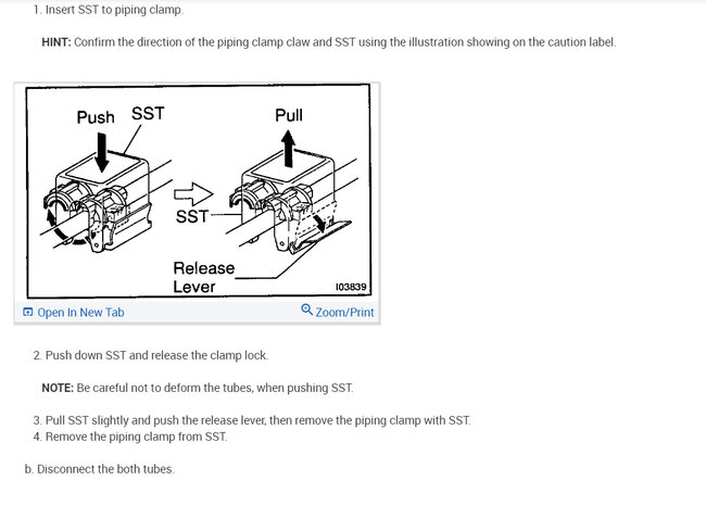

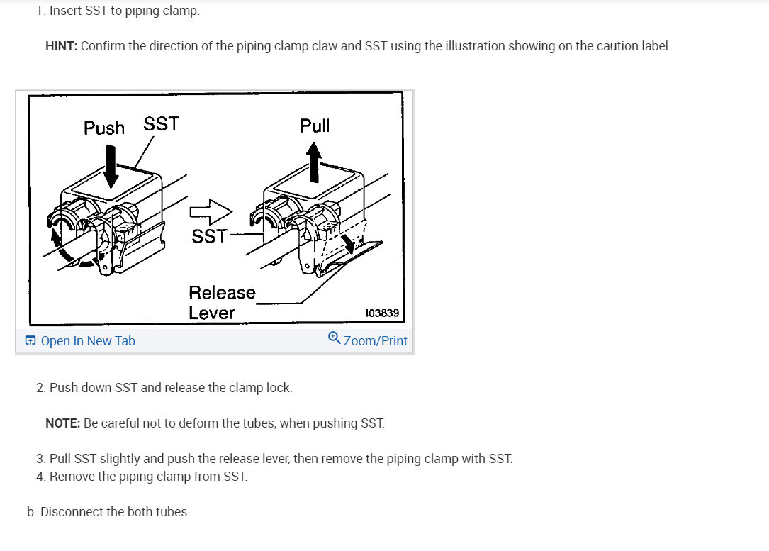

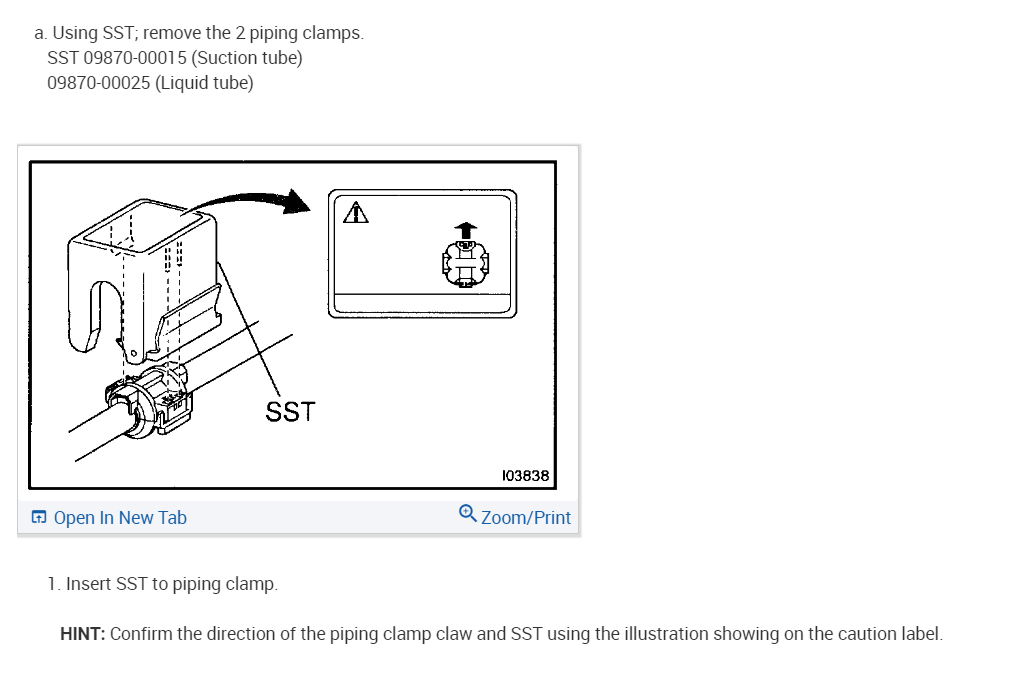

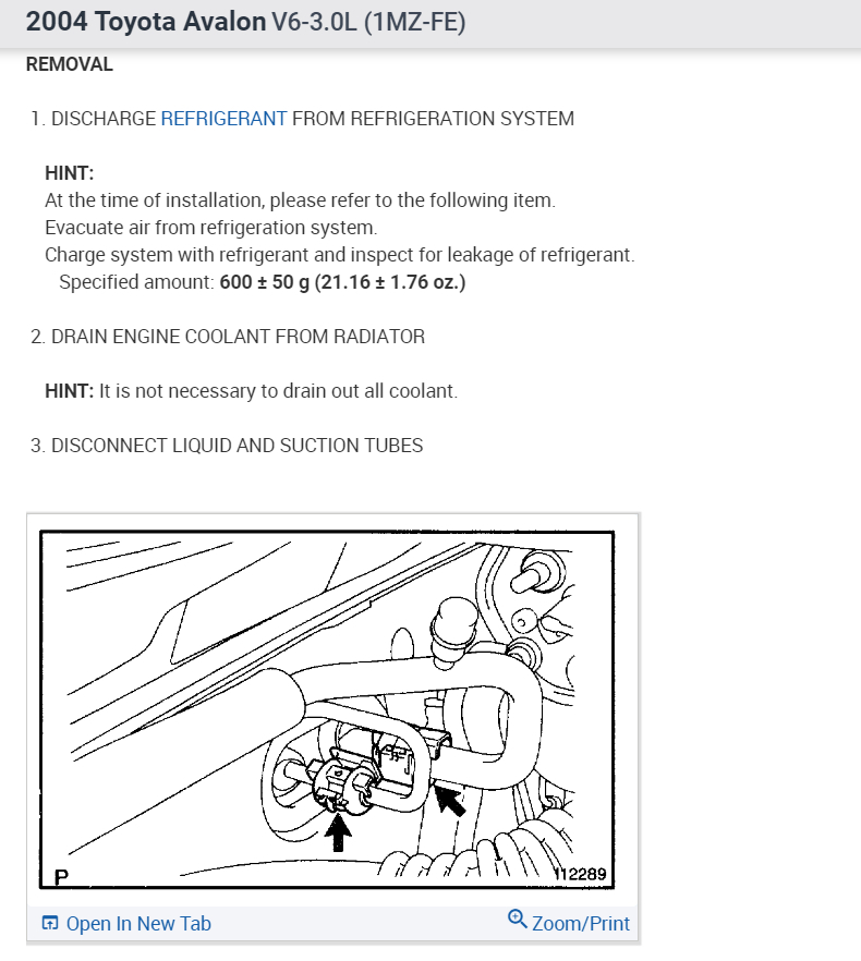

Yes, it is a big job, you will need to drain the engine coolant and vacuum down the AC system.
This video can help:
https://youtu.be/4EqdrBVb0sY
and guide can help as well, and I have included how to do the job on your car in the images below
https://www.2carpros.com/articles/step-by-step-guide-to-replacing-a-car-ac-evaporator
