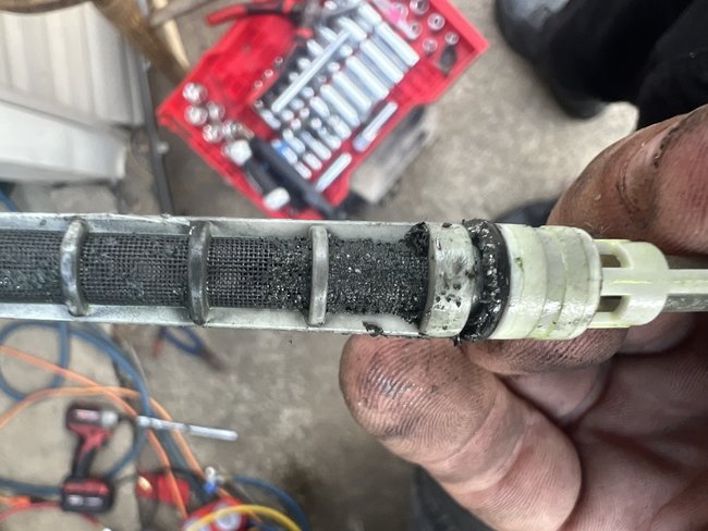

Hello, when I recharge my A/C I don’t lose pressure. I actually gain pressure until the compressor shuts its self-off. I’ve used UV dye can’t find anything. I’ve used an air compressor and soap and can’t find anything. But when I use the vacuum pump to pull all the air out of the system the needle climbs immediately after I turn off the pump, so I know there is air getting in some way. Please help.

Hello, thank you for the response. I’ve already changed the evap, so I know it’s not that. So, you’re saying I should get an electronic detector and go that route? I’ve used the UV to try to find the leak I found nothing. Just wondering if there is a leak wouldn’t the tv dye leak out and show under light or no?

Found the leak replaced orifice no loss of suction in the lines. Recharged the system, it was blowing cold but still gaining pressure, the switch kicked and turned compressor off. I would imagine there is a blockage somewhere after seeing the orifice tube. any idea what to do next?

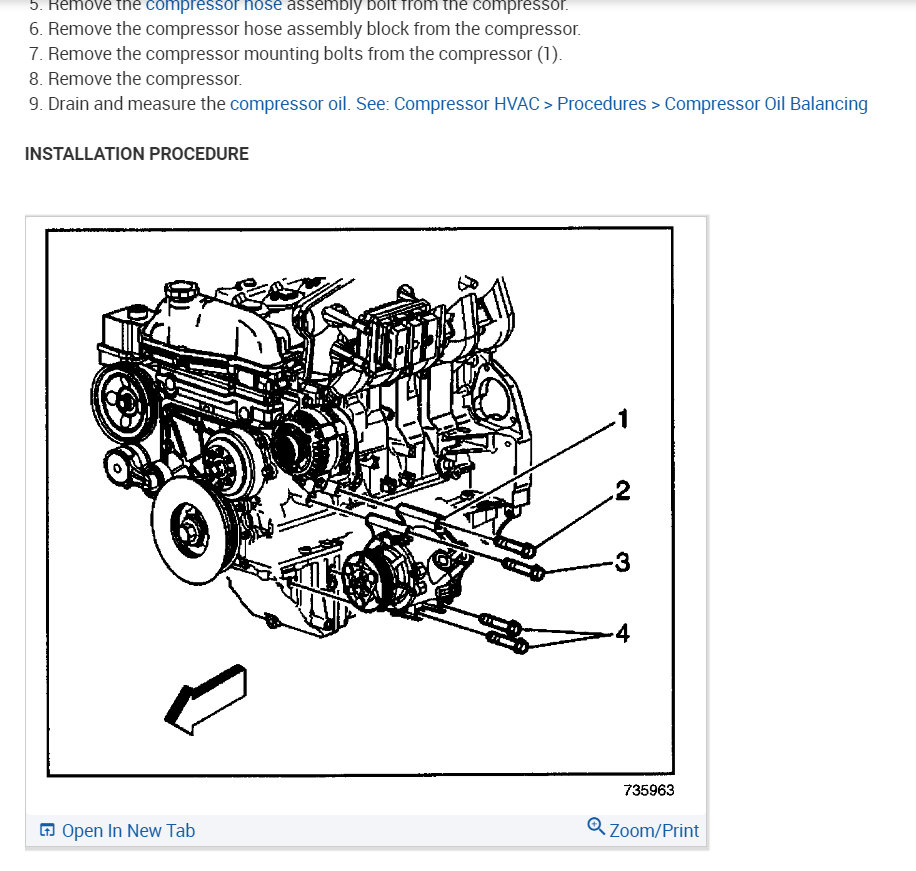

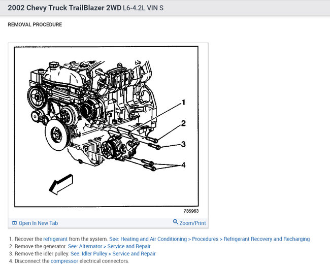

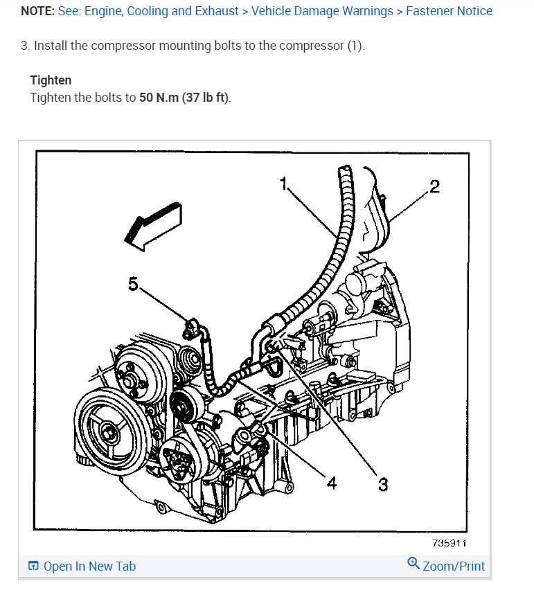

Yep, with the orifice looking like that the compressor is coming apart and spreading the seal material throughout the system. You can get a couple of cans of A/C system flush and a new compressor.
https://www.2carpros.com/articles/replace-air-conditioner-compressor
