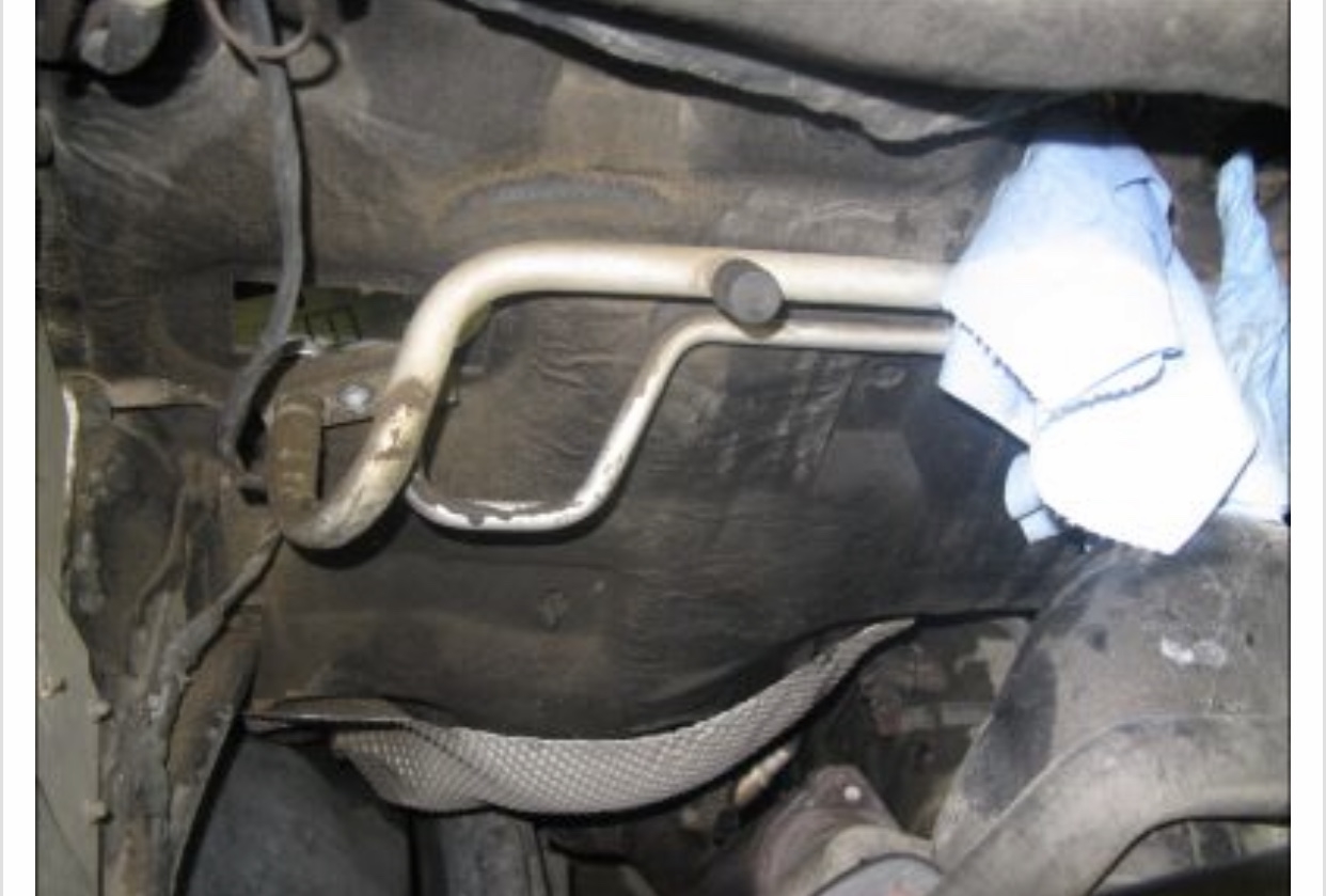

I saw a post where you had pictures showing where the drain system could be clogged but I’m still unable to find where it’s at to unclog it. Any help would be greatly appreciated!

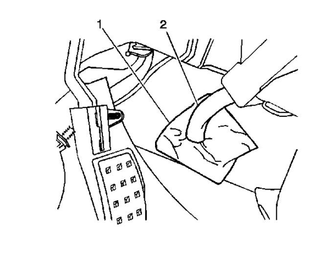

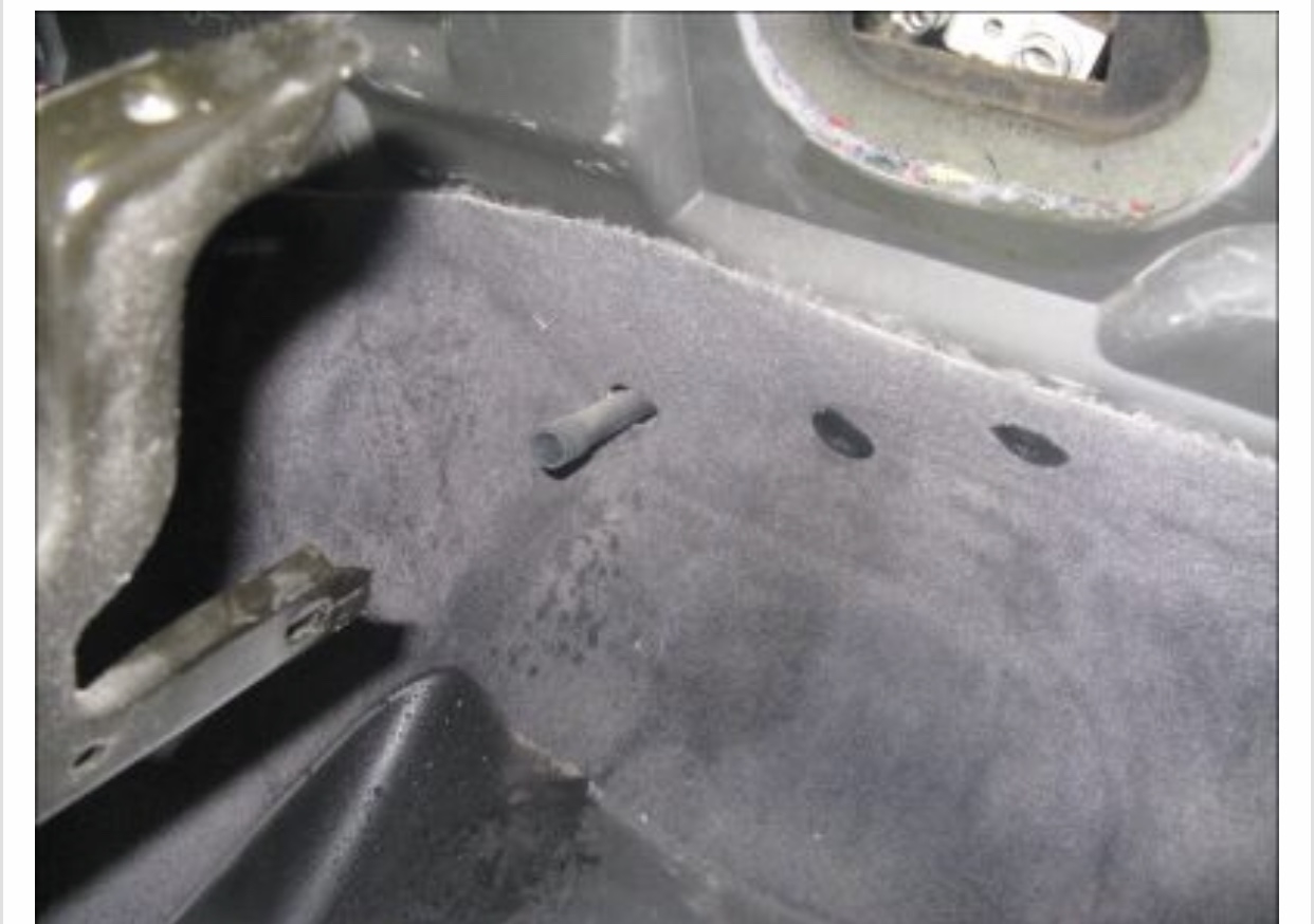

Good afternoon,
The drain hose is in the center console.
I attached a picture for you to view of the hose and access to it.
May 10, 2019 at 6:34 AM
JAYZFANATIK
Do I peel that junk off to get inside the drain line?
May 10, 2019 at 9:16 AM
You can peel it off and lift up the hose and clean it out.
