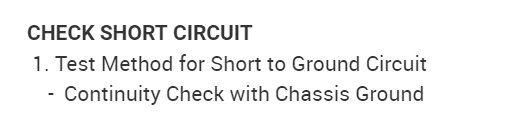

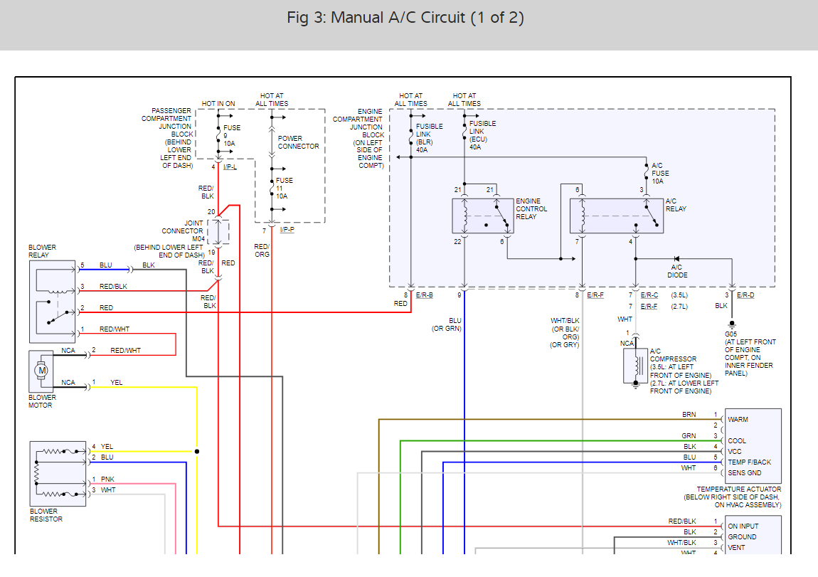

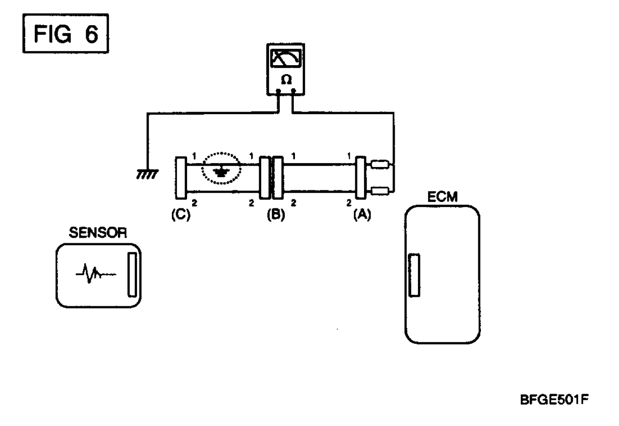

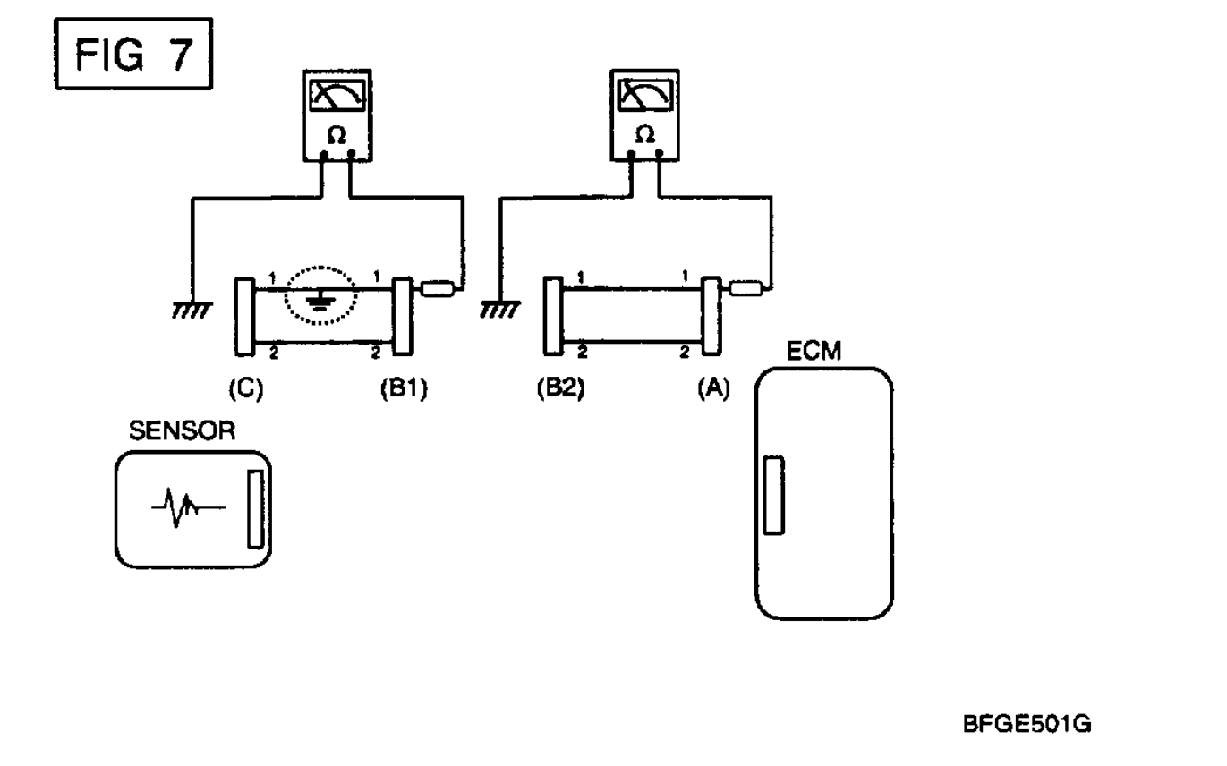

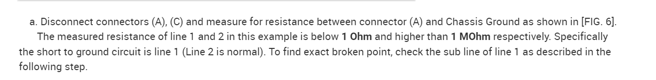

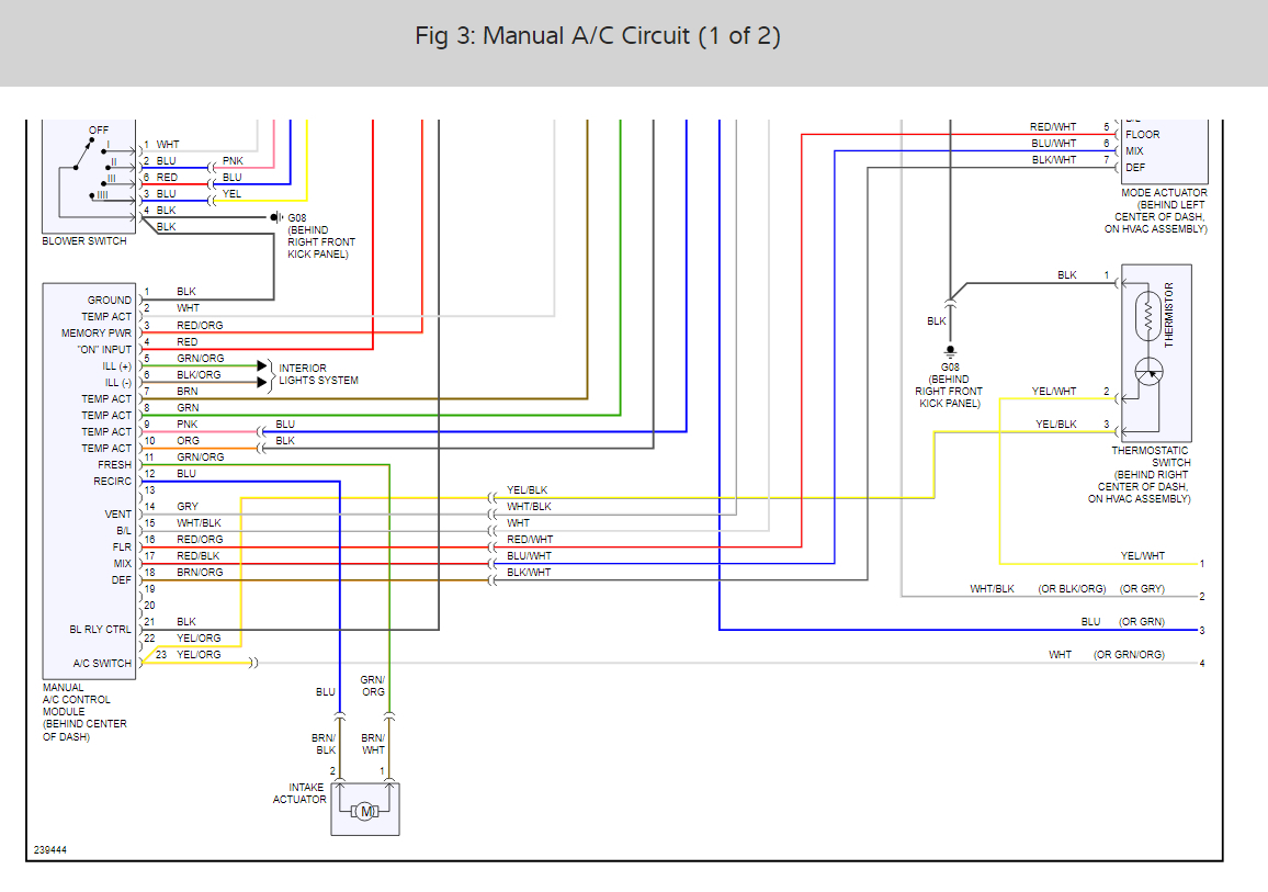

New compressor, condenser, etc. Re-charged the A/C, keeps blowing the fuse. What next?
Jul 15, 2019 at 4:07 PM
SCGRANTURISMO
  • 4,897 POSTS

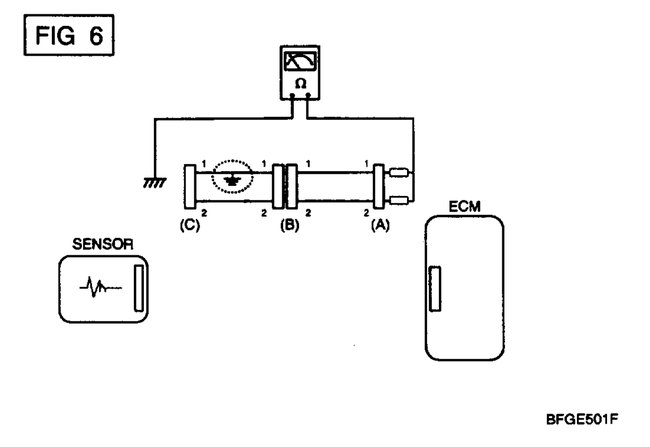

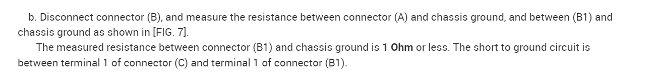

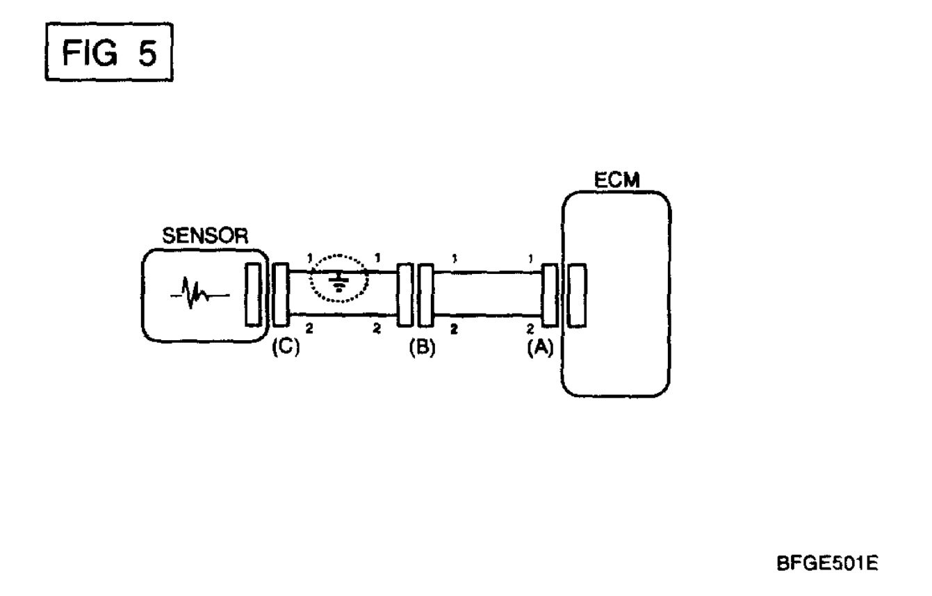

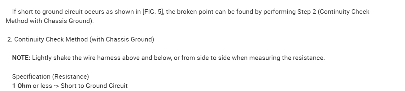

The A/C fuse keeps blowing because you have a short to ground in the circuit that the fuse is protecting. In the diagrams down below I have included a wiring diagram of your vehicle's A/C circuit as well as directions for how to find a short to ground. Please go through these guides and get back to us with what you are able to find out.
