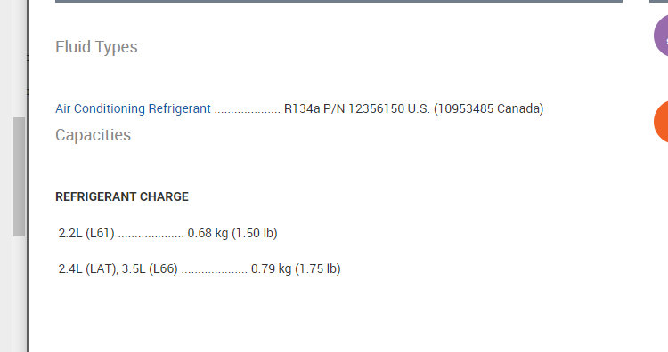

I don't know if I'm not using these darn digital A/C guages correctly or what they seem to be harder to use then the manual ones. but i'm going to upload a video of the way i'm using them later so hopefully one of you guys can watch it and verify or tell me what i'm doing wrong. When i jumped it at boc and after i refilled with least can and half nothing as far as cold air goes still blowing hot and shot quite a bit of dye in there not seeing any leaks anywhere didn't want to over fill so stopped there.
Sep 9, 2021 at 6:49 PM
Okay. Yeah, a video would help because they should operate the same just a digital read out rather then analog but I have never used them because I prefer the analog as that is what I am use to.
However, seeing what you are dealing with will help us figure out next steps.
Is the compressor coming on after you filled it with a can and a half of Freon? Depending on what engine you have, it appears to take 1.5 -1.75 pounds of Freon. Normally on can is about 1.25 pounds so after a can the compressor should be on.
