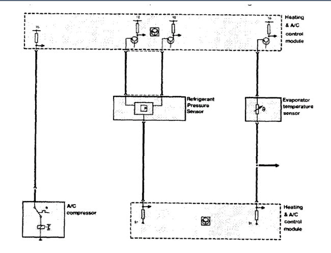

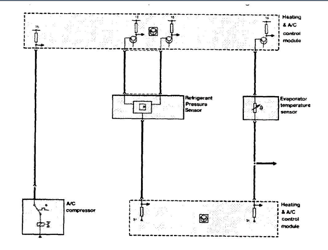

  • 110,248 POSTS
When it was doing that, was the compressor still engaging? If it was jumping back and forth between temperature (working and then not) are you sure it isn't an air temperature actuator issue?
Also, there could be an issue with the control module. Can you scan the can bus system if there is a break down in communication?
