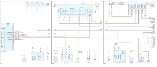

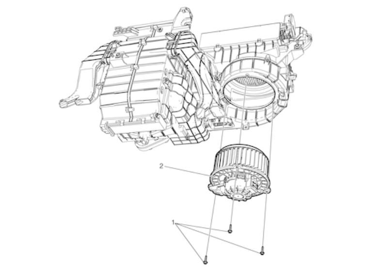

i am having issues with the car listed above's air conditioning. the compressor is working. but air is not reaching the vents. i have replaced the blower motor and no change. the control panel all lights are lighting up.

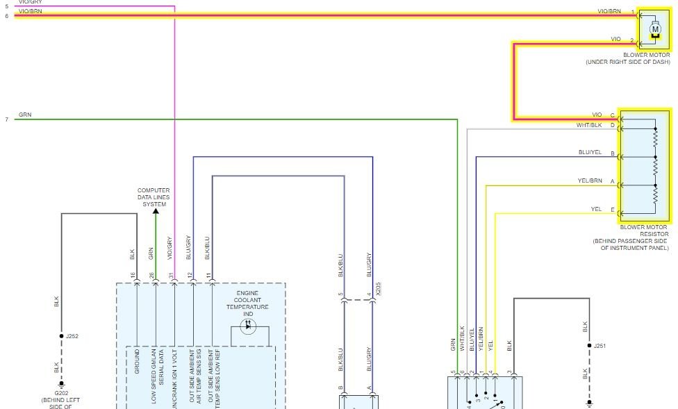

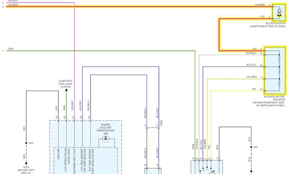

Do you hear the blower motor working?
I attached a wiring diagram for you to view. Check for power to the blower motor with a test light or voltmeter.
Jun 26, 2019 at 7:09 AM
KDEERING
it might take me a day or so to get the information back to you. or to find someone who knows how to use one of those. ( i do not) will get back with you.
