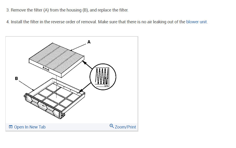

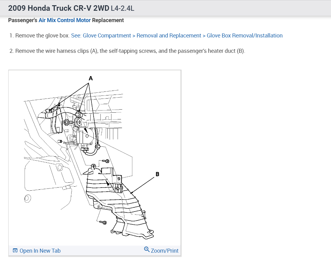

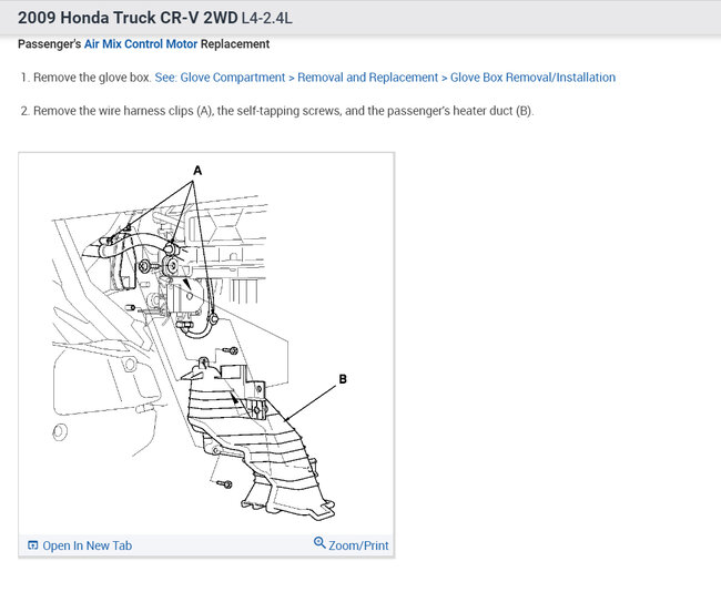

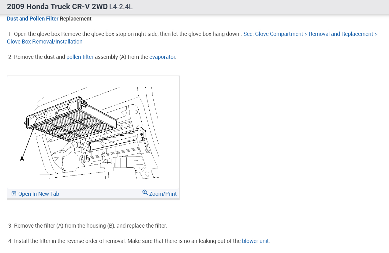

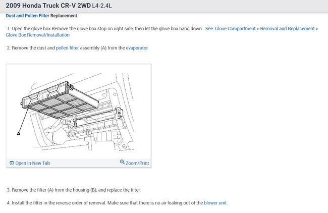

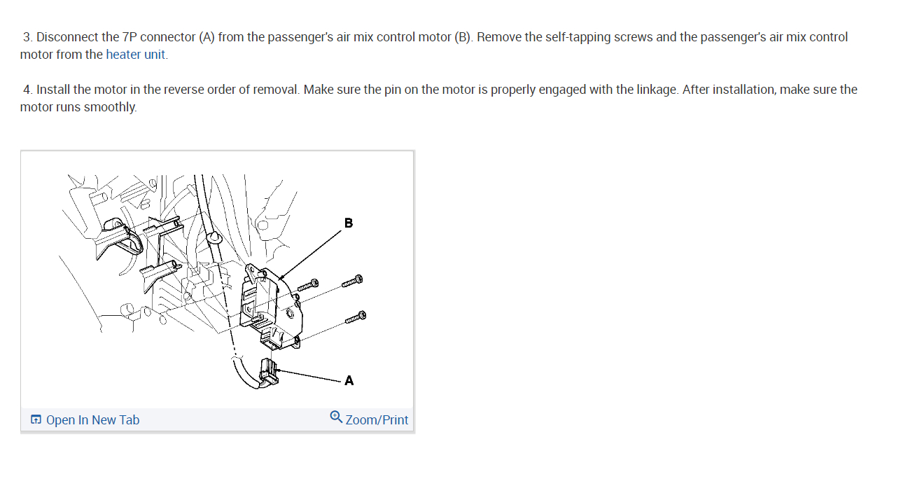

This sounds normal for the temperature knob problem. I would check the cabin air filter and replace the blend door actuator on the driver's side here is the location of the cabin filter and actuator so you can get the job done. Also make sure the coolant is topped off. Check out the images (below). Let us know what happens and please upload pictures or videos of the problem.
