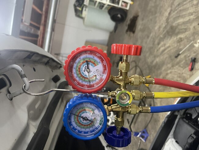

A/C issue, air not cold?
2014 HYUNDAI SONATA
148,000 MILES • 2.4L • 4 CYL • 2WD • AUTOMATIC
BHAMDOC1973
  • 2,007 POSTS

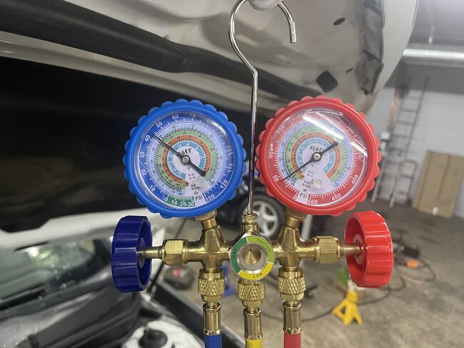

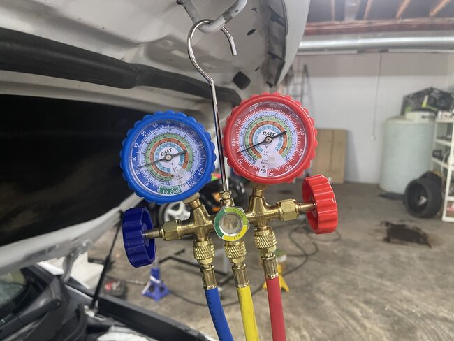

Air not cold, compressor turning. The first picture is with the engine off. Second, engine on and knobs on ac ports open. Third picture both high and low open on both the gauge and ports.
Jun 25, 2025 at 11:45 PM
  • 55,433 POSTS
So you never open the high side valve (red). It looks like the system is low on refrigerant. Please go over this video and let me know what happens:
