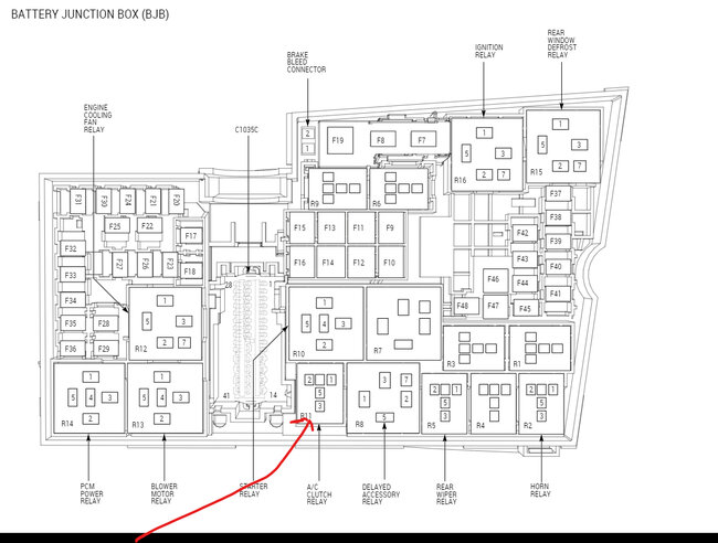

It was okay, then today i was cleaning it out and noticed it isn't as good, so checked pressure and was more than full. Let Freon out but all that came out was air. Usually, i have seen this, is when moisture ir air is in place of Freon, so let most of it out until compressor stopped, now it won't come in as its low. Fan was working when compressor was on. Saw bunch if relays in engine box but nothing is labeled, want to jump it so i can feed it enough Freon to work on its own. Or can i charge it from high pressure while the engine is off?

That is what i did. Compressor not coming on like i said because its low now.

Can you help me find where the A/C compressor relay is located, and which pins could get it kick in so i can charge it?

Sure, here it is. Check out the images (below). Please let us know if you need anything else to get the problem fixed.
