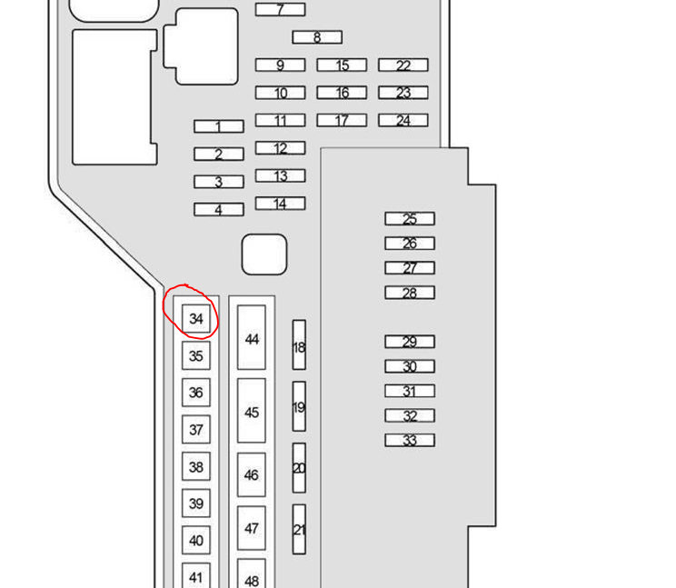

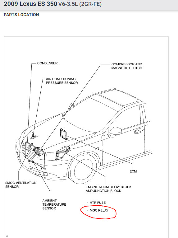

Friend if mine's car. His A/C was not cold and fan not running when i checked. Lexus said that the 50a fuse is blown and needs to be replaced and that the fuse box needs to be disassembled to do that. i want to change it for him. Any instructions on how? They are asking too much for labor. They said no power going to magnetic clutch relay or the fans.

That fuse is located in the fuse box under the hood. That fuse box is located close to the driver side fender (see diagrams).
The fuse number is 34 (50A).
You will have to remove the plastic covers for the engine to get to the fuse box.
After that you simply take off the cover the replace the fuse. You do want to make sure that the fuse is indeed faulty.

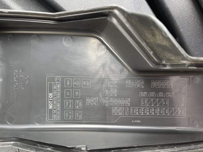

Car is not working this morning, strange. Jumped it and went for a rode all good. Alternator charging 13.7v. Came back from a 5 mile drive, parked it. Turned it off and started twice no problem, left it for 30 minutes came back and its totally not working. Battery .82v, what the heck. How is that possible? This is the fuse cover. Anything you suspect that causes that?

SQM
  • 6,383 POSTS
It appears that the vehicle has an excessive amount of parasitic draw.
A parasitic draw (current drain), can be caused by a number of electrical equipment. It could be as simple as a glove box or a trunk light staying on. It can also happen for a short in a electrical circuit like a window switch etc.

Ya, I checked all the lights and none are on. I doubt it is a light because the drain is quick. It may be a short due to the smoke that I saw when I installed the ac fuse. One thing after another with this car.
Aug 21, 2021 at 4:53 AM
SQM
  • 6,383 POSTS
It does sound like a short. Try removing that 50A fuse and see if the current drain still exists. It could the harness for that fuse.
