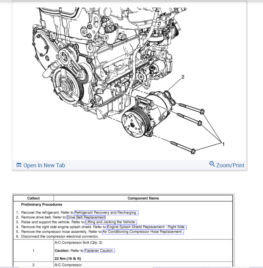

45 is too high. It should be 25 to 30.
No, a weak compressor will not build pressure.
The 90 on both indicates a possible compressor. If the compressor is engaged then it needs a compressor.
https://www.2carpros.com/articles/replace-air-conditioner-compressor
I attached the procedure for the compressor replacement.

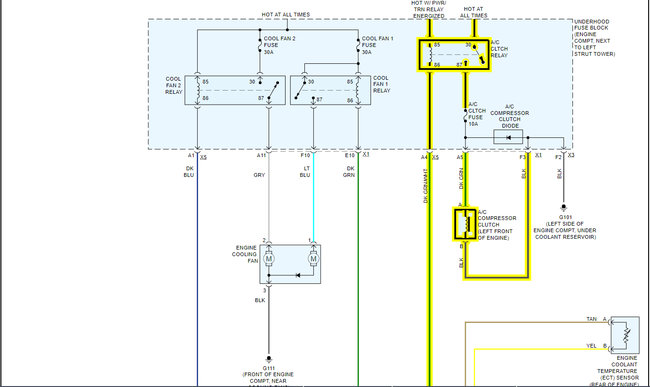

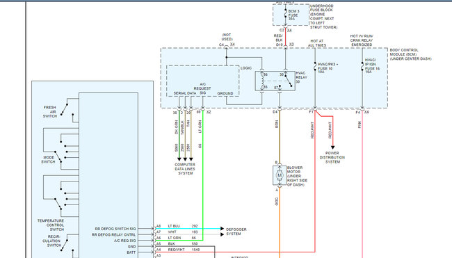

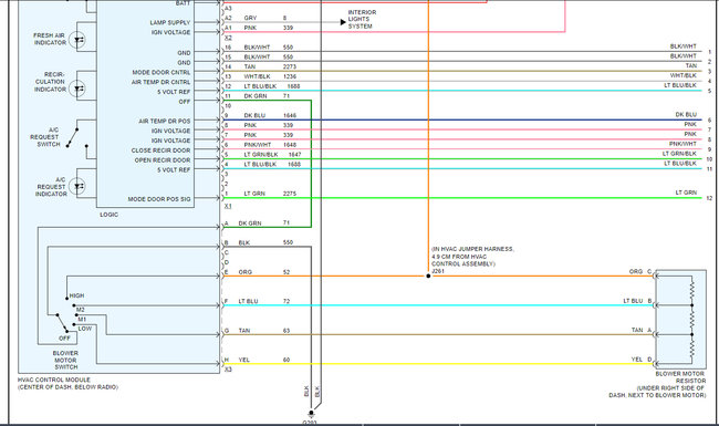

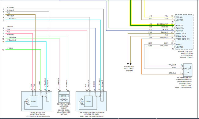

I also attached the wiring diagram for the compressor in case it does not engage.
