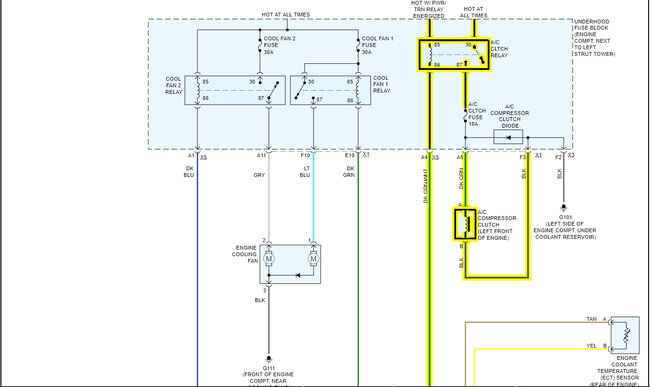

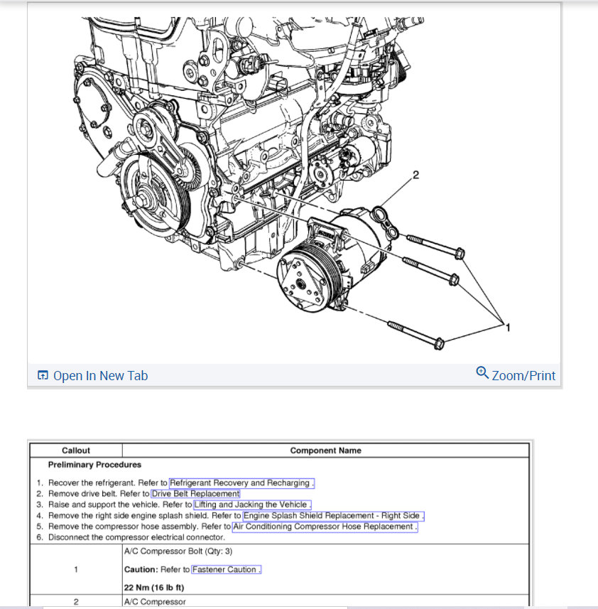

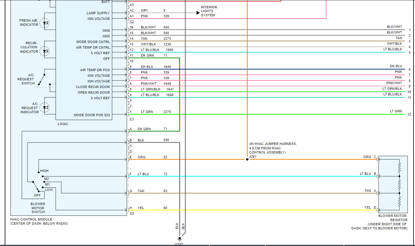

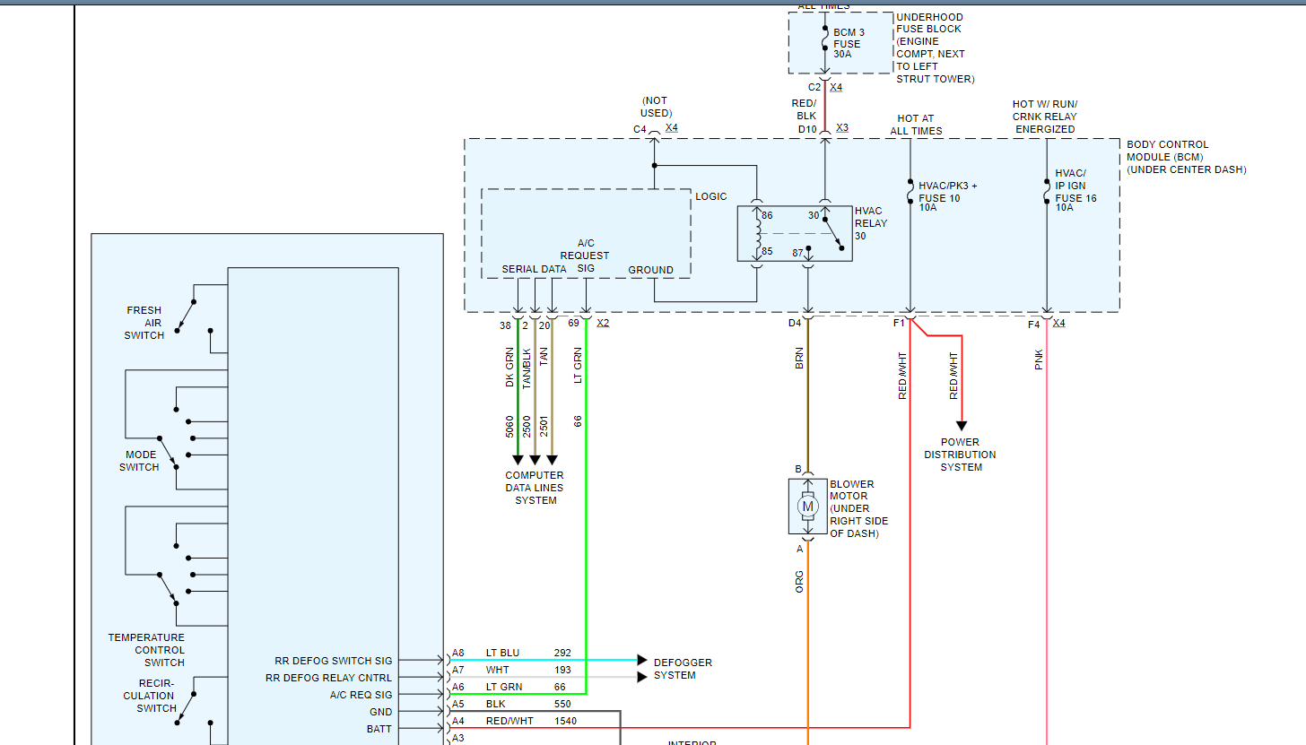

https://www.2carpros.com/articles/replace-air-conditioner-compressor
I attached the procedure for the compressor replacement.

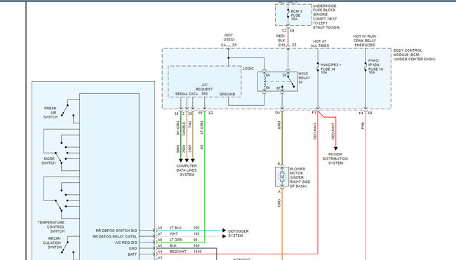

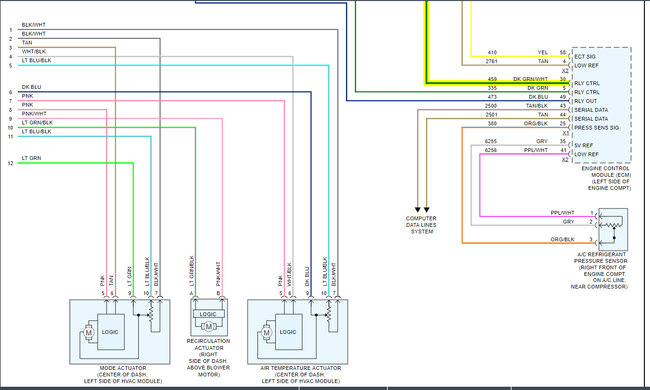

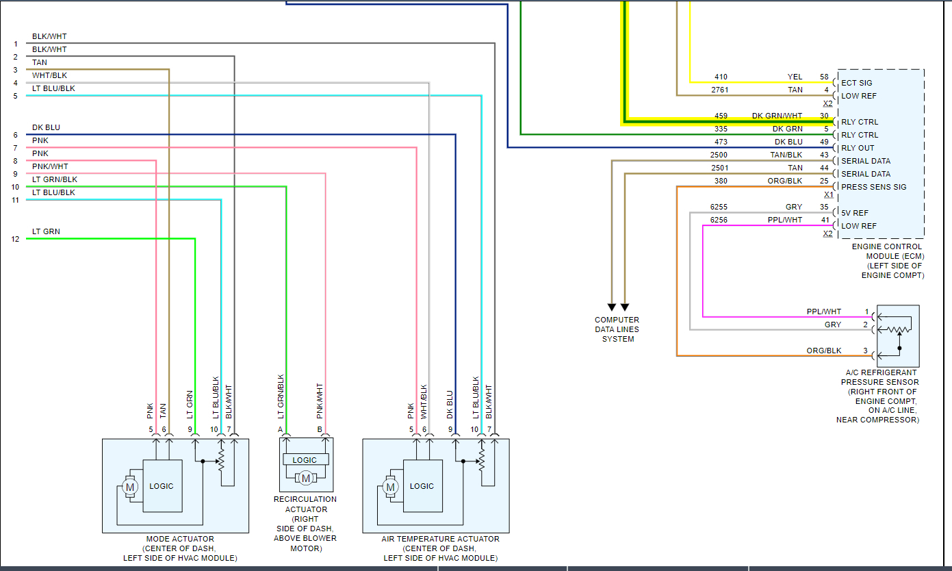

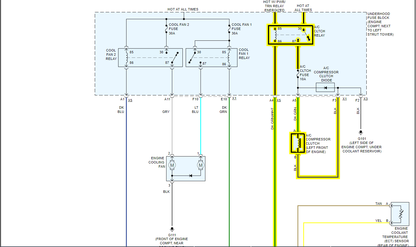

I also attached the wiring diagram for the compressor in case it does not engage.
