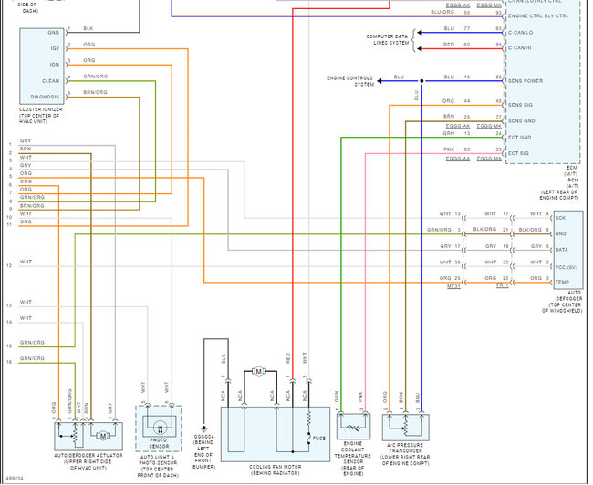

The car has low miles so it's strange. I hooked up the gauges and opened the low side and it showed full, high side i think it was around 100. Not taking any freon. I have never seen these types of compressors. It turns but i think these come out when it engages so i don't think it is. Where is the relay for it? I checked the fuses and they fine. I saw the fan working at some point but it's not on with the A/C on. I guess compressor must engage first.

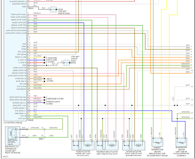

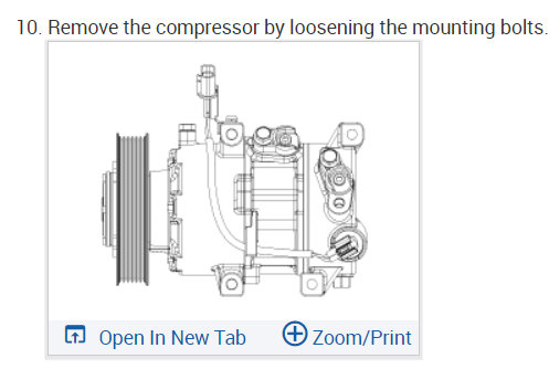

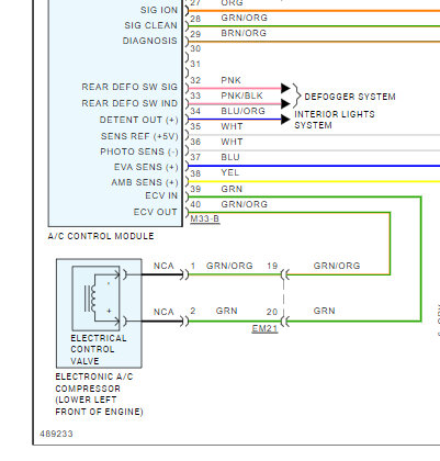

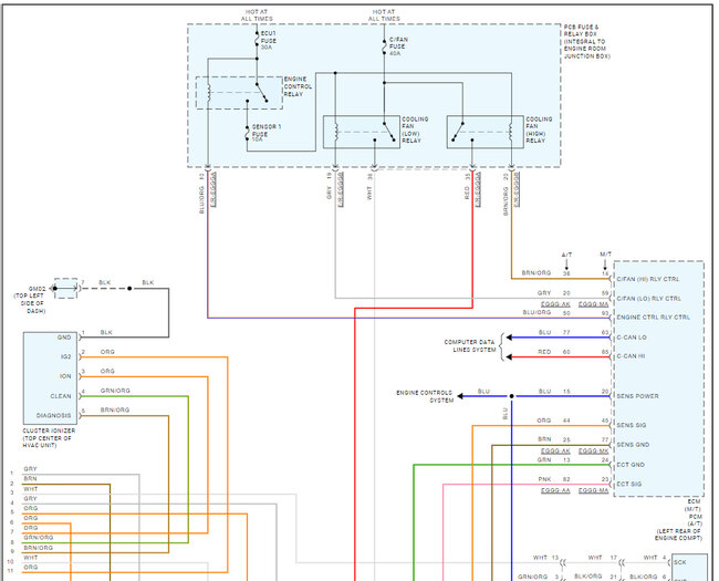

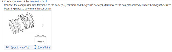

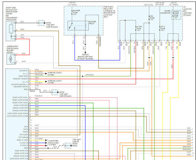

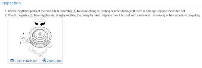

This car does not have an A/C compressor relay because the A/C control module varies the voltage to the internal valve inside the compressor, here are the wiring diagrams so you can see how the system works. I would check all fuses and then do a CAN scan to see if any codes are stored for the AC control module, if not remove the connector at the compressor and use a voltmeter, when you first turn in on it should go to 12 volts and if so, the compressor is bad.

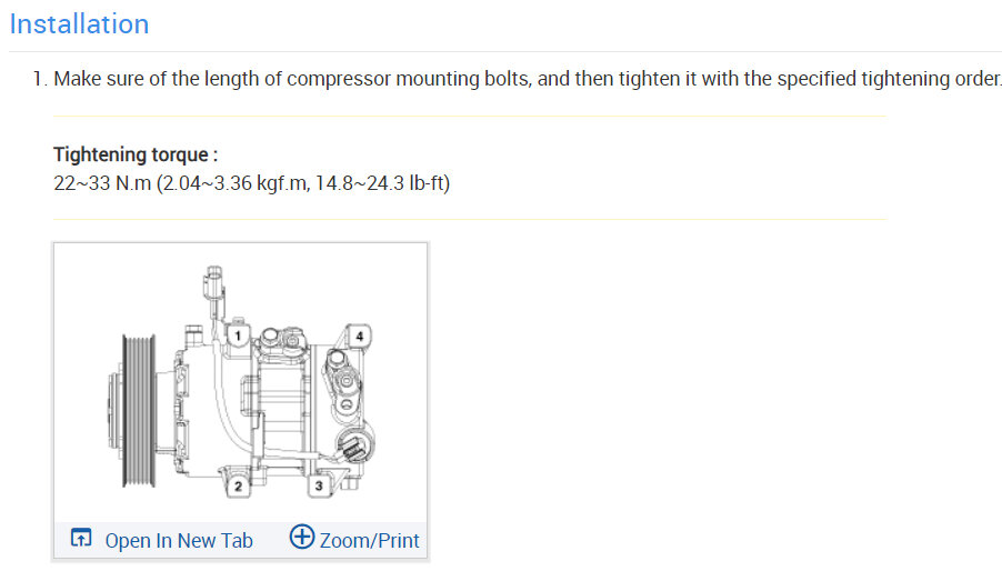

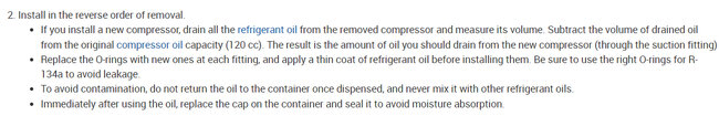

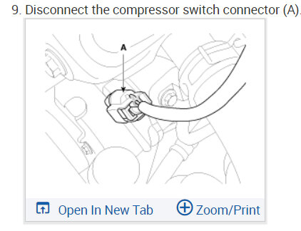

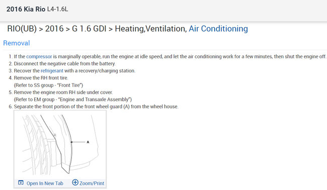

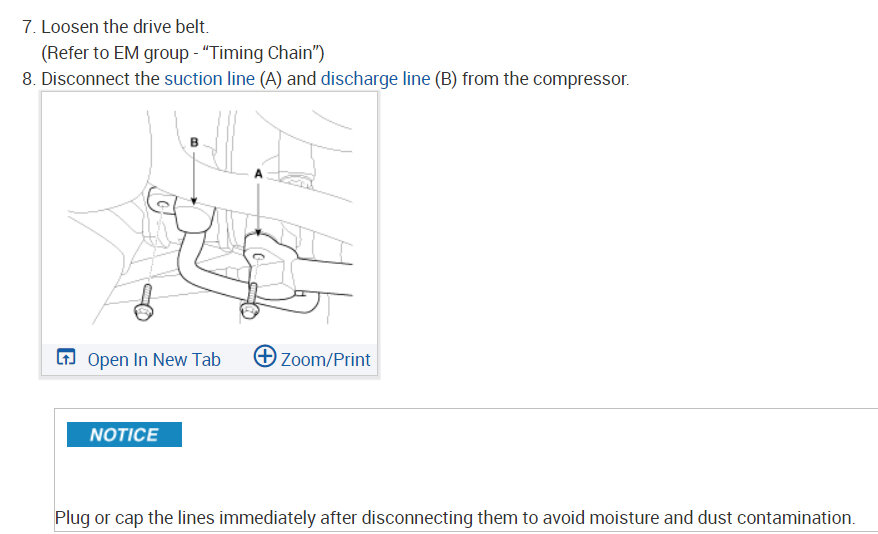

Here is a generic guide to help you step by step with instructions in the diagrams below to show you how on your car:
https://www.2carpros.com/articles/replace-air-conditioner-compressor
Here is how to change the compressor out in your car. Check out the images (below). Please upload pictures or videos in your response to the problem so we can see what's going on.

What do you think?
Apr 19, 2024 at 4:09 AM
  • 55,554 POSTS
Yep, it is getting signal, I would replace the A/C compressor, the seal has let go, thanks for the video, please let me know if that works.
