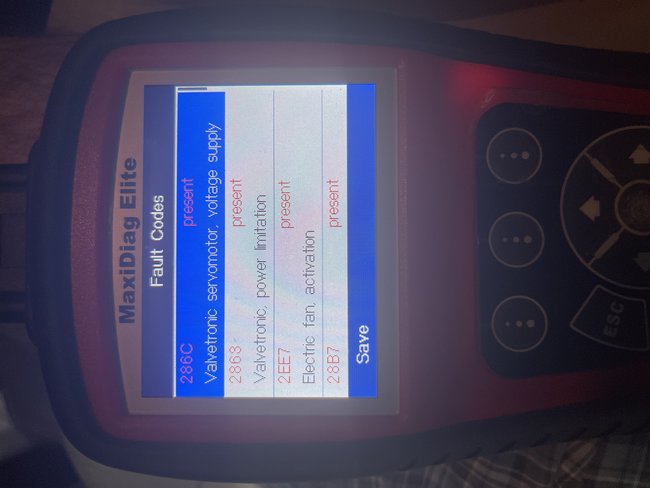

Well dang, was checking relays and i removed the front one from the under-hood box, the car turned off, when i turned it back i got these codes and now no throttle response.

Here and the battery volts are 12 not charging.

Also, when i received the second relay to test it i jumped 87 and 30 and the wire got hot so i removed it. Then i removed the first relay and the car shut off.
Aug 19, 2022 at 11:19 PM
BHAMDOC1973
  • 2,007 POSTS
Also, power steering is hard and engine running rough, dang it. Not sure if the first relay is different than the rest but the numbers are on that specific one, even though all are interchangeable.
Aug 19, 2022 at 11:22 PM
BHAMDOC1973
  • 2,007 POSTS
No won't start but for 1/2 a second then shuts off. Man what did i do?
Aug 20, 2022 at 9:34 AM
BHAMDOC1973
  • 2,007 POSTS
Found the issue because it won't run, fuse 5 was blown. Now the ac issue. I have another mini so i swapped the relays and still nothing. Swapped the relay in the kick panel on passenger which i think is the one for the compressor still nothing.
