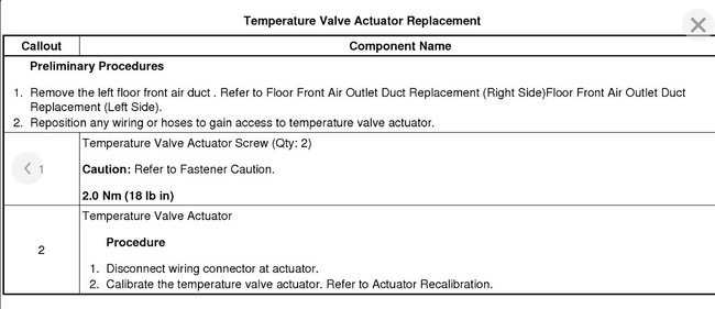

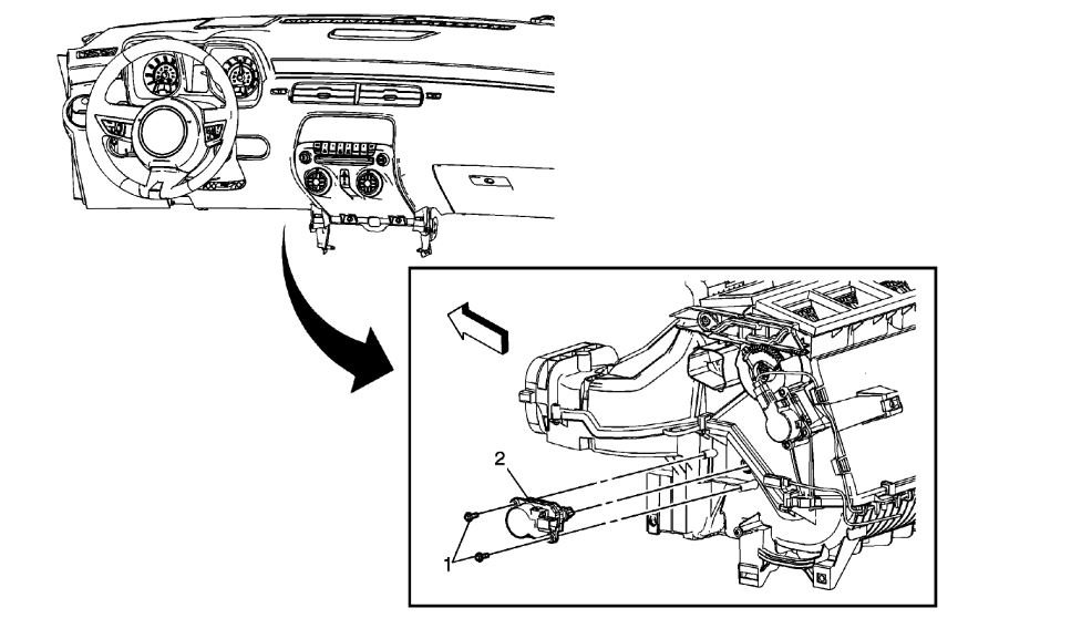

Then chances are the mode door is not working. It is under the dash on the left side as in the picture. put your hand on it and check again by changing heat to cold and see if it is working.
if it is not, then replace it.
