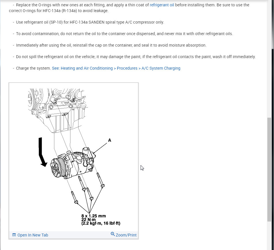

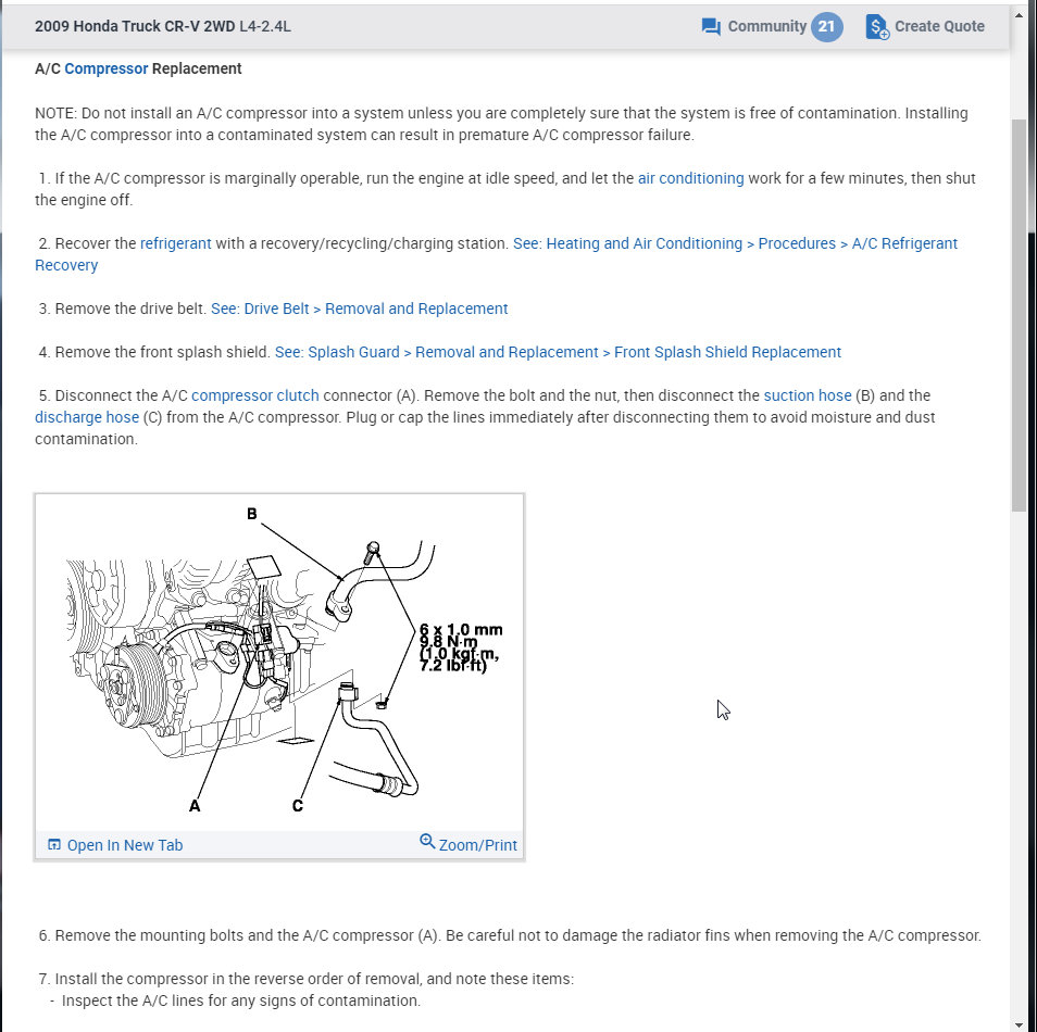

Just a follow up here. We took the car to Jiffy Lube today for a Freon treatment. They didn't put any in and told us that the car does not need Freon. He said that the car's compressor isn't working. Is it possible to tell how much Freon is in a car? Can we trust this?
If it is the compressor, is this a part that can easily be installed in a CRV?
Thanks,
Chris
May 10, 2020 at 5:22 AM
I attached the process for your review.
As for knowing if it is full, they can tell this by hooking up a gauge set and seeing what the pressures were in the system. If they did this they should be able to tell you what the pressures were. Some people just push down on one of the valves and see if there is pressure and Freon in the system and think that is sufficient. These people should not be working on cars. So if they gave you a receipt, see if it lists the pressures. If they don't call and ask them what they were. If they don't remember then I would either get a second opinion or make them do it again and give you the numbers.
I attached a chart of proper pressures based on ambient temps. Let me know if you get the pressures and we can figure it out. Thanks
