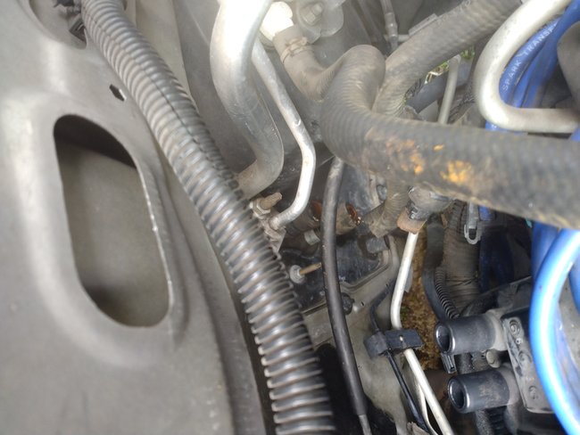

What would be the size of the hose or can I get it somewhere ? It's the ones that go to the car like behind the motor. Not sure what hose they're called but is there anyway I can buy a replacement?

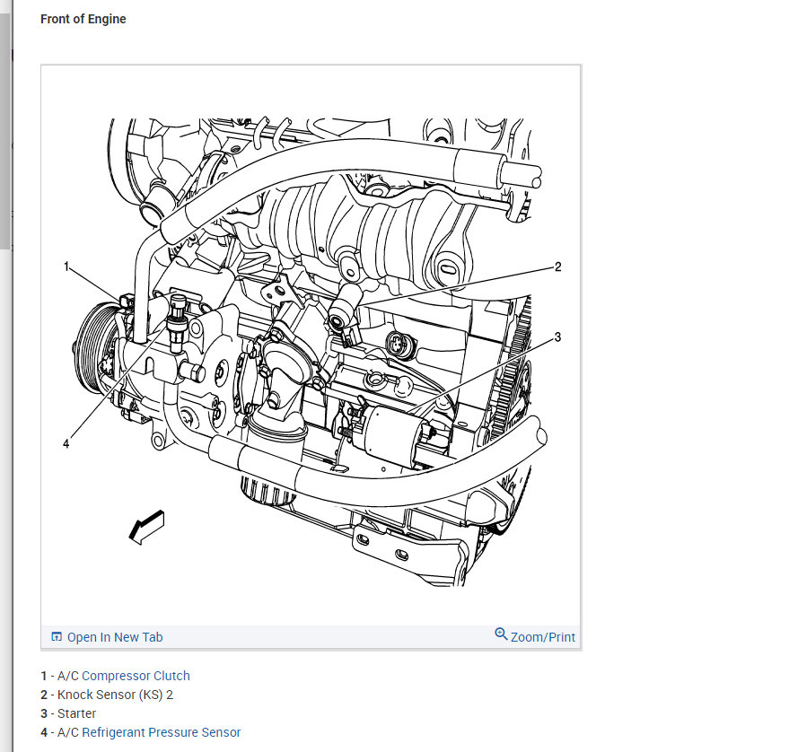

Below you will find a diagram of the two large lines that run from the compressor. Do one of them look like the line that you need?

It's the two hoses that go into the car the cold and heater i'm assuming.
Sep 10, 2021 at 2:01 AM
Got it. Those are heater hoses. There are various options but most parts stores will pull up a part number for a molded line.
Here is a link to a parts site that has many options:
https://www.rockauto.com/en/catalog/chevrolet,2007,equinox,3.4l+v6,1434135,heat+&+air+conditioning,heater+hose+/+pipe,6892
Basically most all of them are cut to fit so they are in the general form but are long so that you can cut them off on your set up.
You can also just use bulk hose if you want to. There are normally not many serious bends that require a molded line.

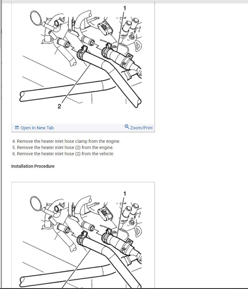

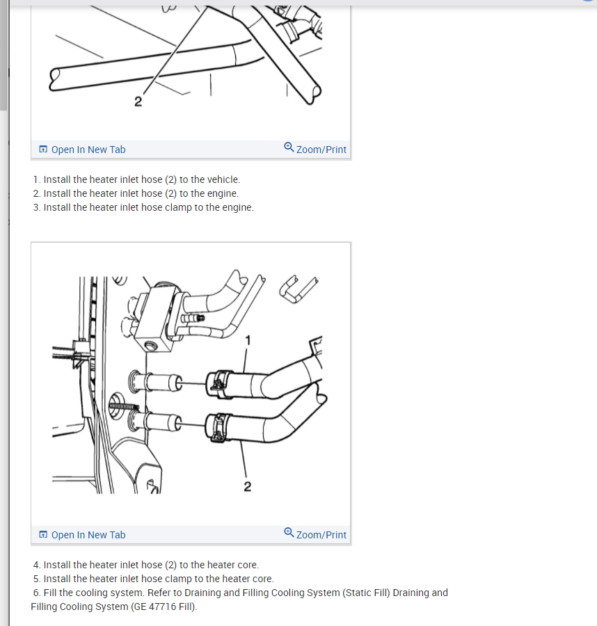

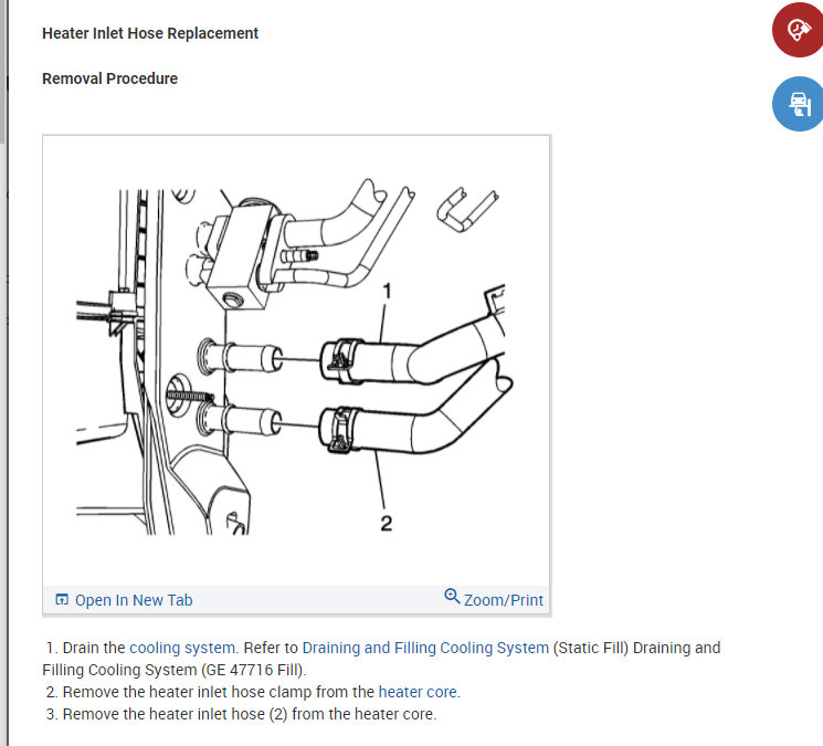

Below is the process from the manual on how to replace them.
