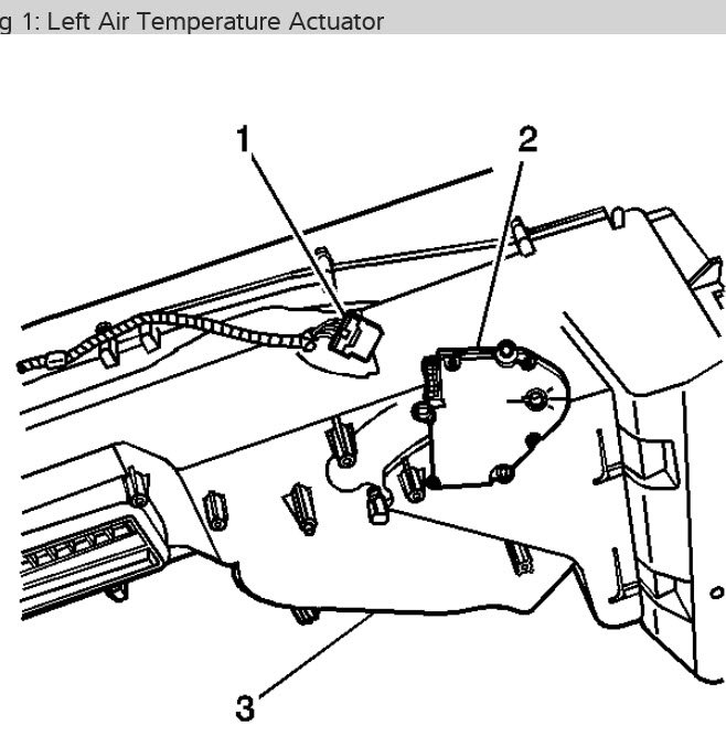

My 2004 chevy 2500 blows hot air on driver side when ac is on but cold on passenger side heat works fine on both sides I have the manual dual climate control that slides up and down is this going to be the blend door by the hump under kick box? Defrost floor and everything else works fine just hot on driver side while in ac thanks for any info

try pulling hvac fuse inside truck first it may reset the blend door for drivers' side. if not it may be a blend door problem or not getting power it's on bottom on pass side you'll have to remove a panel to access
Apr 7, 2016 at 6:52 AM
HMAC300
  • 48,601 POSTS
leave fuse out for at least 60 seconds with key on
