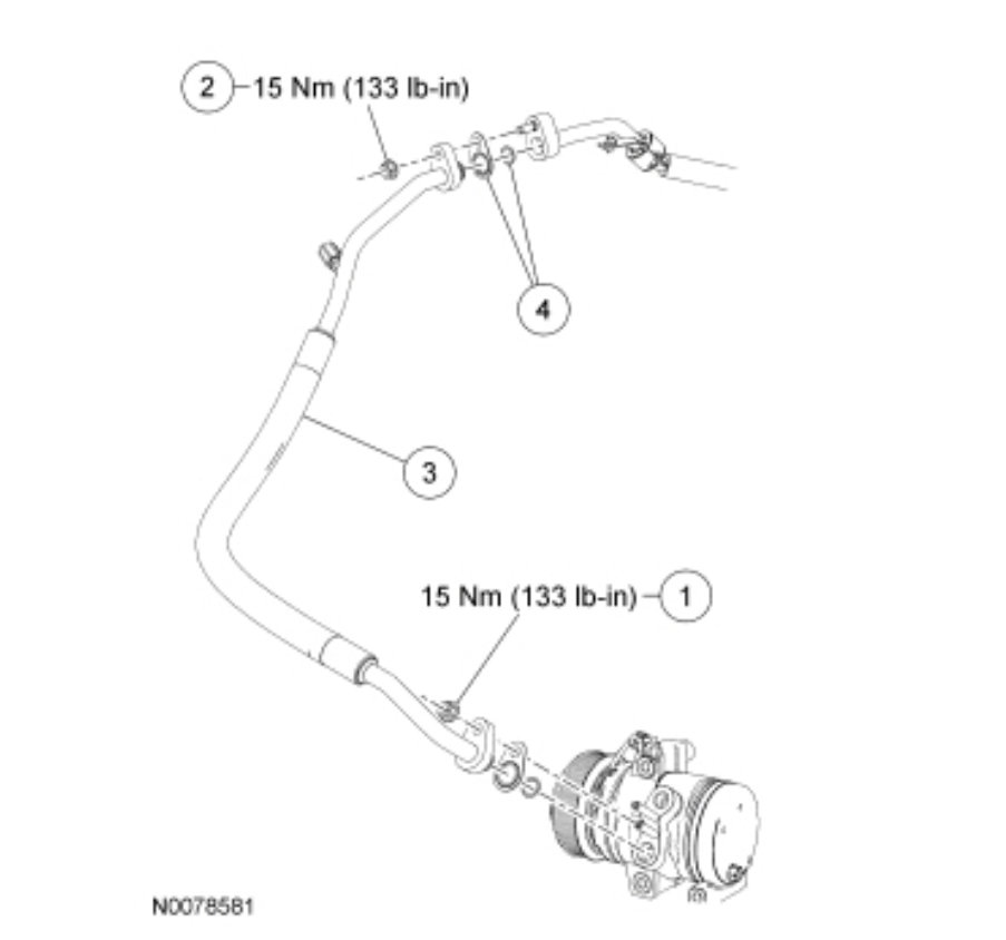

My AC has stop working today and I'm trying to trace where the leak is located. I bought a dye at autozone and the instruction said that I need to connect the dye can and the connector to the low port and the rechargeable can (Freon) to the high port. So far no luck of finding the location. Could you please help me find where I can locate those two ports so I can figure out my next step. Thanks you soo... much for your help.
Jul 12, 2015 at 6:44 AM
CJ MEDEVAC
  • 11,004 POSTS
The charge port is under the passengers side fender well which will need to be removed before charging can occur. this video can help with diagrams below to show you the location.

Thank you for your help, but unfortunately I did everything the guide said step by step. I use a vacuum and put a dye using the low port. There are no signs of leaks using my UV light. Few days ago I recharge the AC with 2 12oz cans of the Freon using the low port. It work for a while but today the air blow warm air and no feelings of coldness or changing of the air when I turn on to AC. This leads me to try the dye today to see if there is any leaks. As I mentioned above, there is no signs of leaks using my UV light. please help and thanks.
Jul 12, 2015 at 11:01 AM
CJ MEDEVAC
  • 11,004 POSTS
it's really sounding like a leak
Just this guide out.
https://www.2carpros.com/articles/air-conditioner-leak-detection
