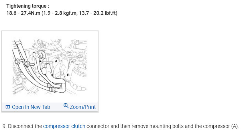

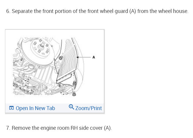

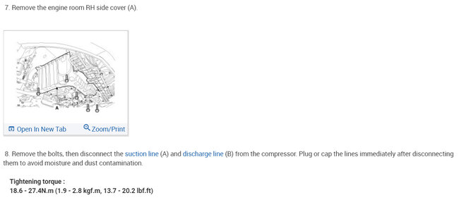

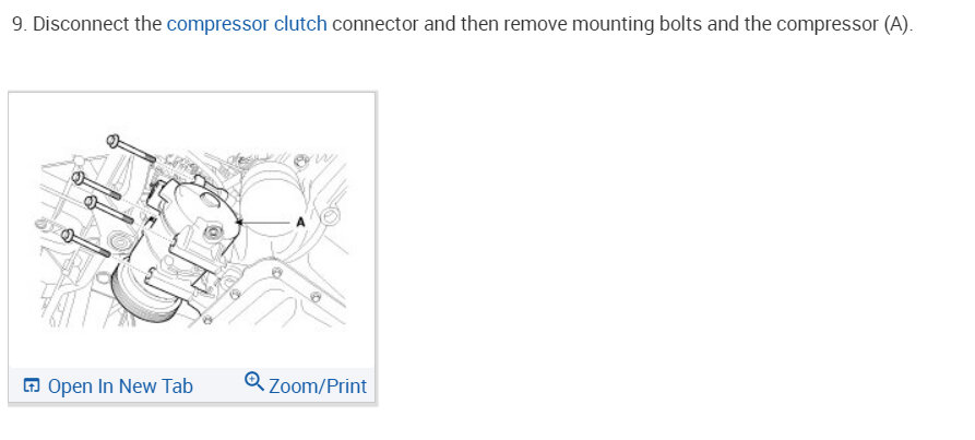

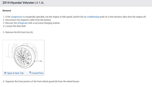

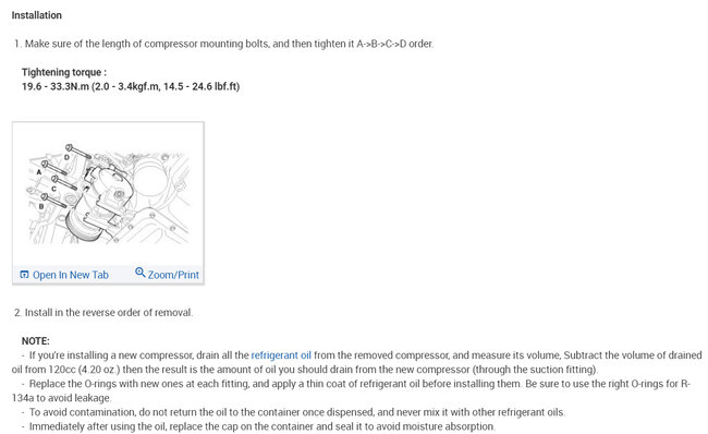

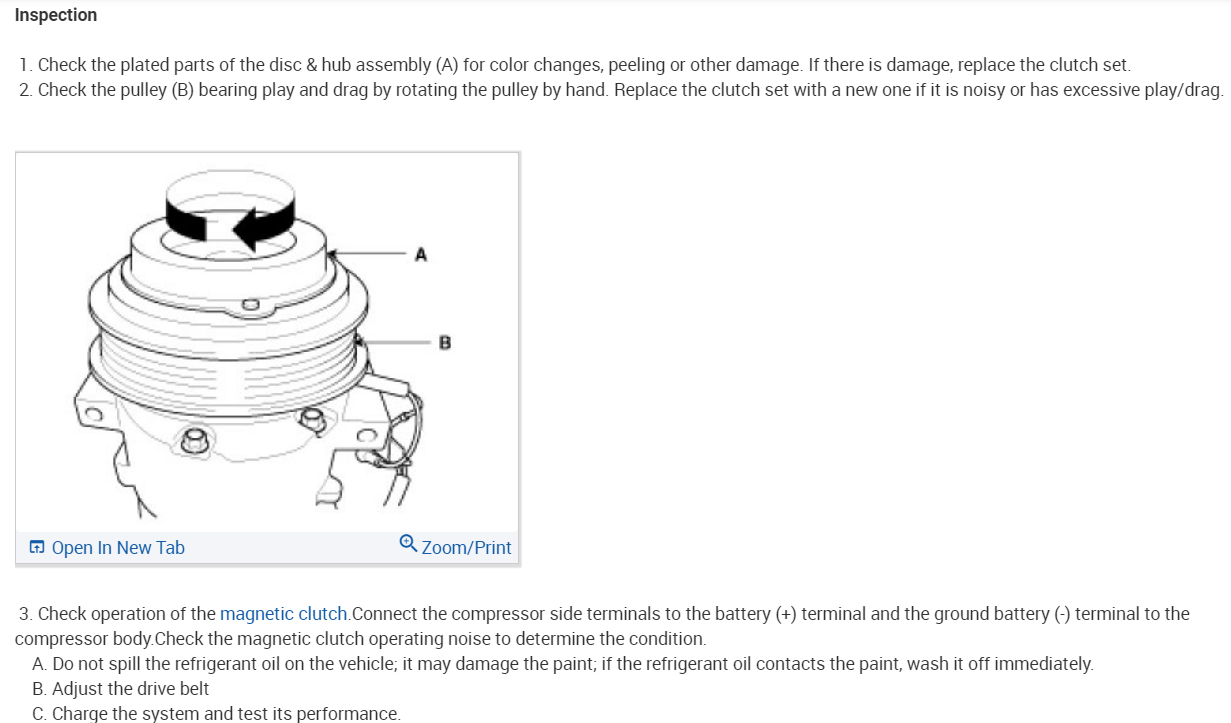

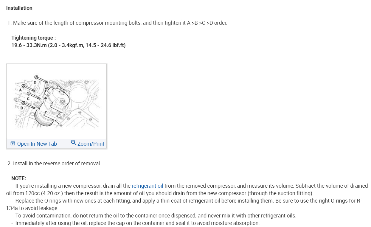

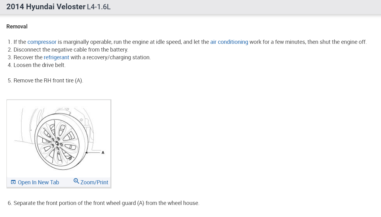

Yes, this means the A/C compressor has gone out and needs to be replaced. Here is a generic guide to help you step by step with instructions in the diagrams below to show you how on your car:
https://www.2carpros.com/articles/replace-air-conditioner-compressor
And this guide can show how to vacuum and recharge the system:
https://youtu.be/4EqdrBVb0sY?si=X9tl7Syl9c0Qbuna
Check out the images (below). Please let us know if you need anything else to get the problem fixed.

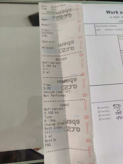

What I did yesterday is the following,
I did a full system recovery and charge, I did it just to try and see what will happen and because it's cheap like 25$ for the service.
The results:
1 - The recoverd refrigerant 0.296KG and 0 oil for a 5 min vacuum.
2 - The machine didn't know how much refrigerant needed to charge the system (no sticker under the hood) So, he put 0.500KG and 5ML of oil.
After the service nothing happened, same as before.
Now, I have some questions,
1 - Is the amount correct? For the refrigerant and oil? Or need to be more or less? I couldn't find how much it should be, I googled and went through the owners manual and nothing.
2 - From the recovered data, dose it mean anything? Like the 0 oil does it mean bad compressor or something else, my question is can this data be a diagnosis data?
The second step from here I think I will go with the cheapest option and change the expansion valve do you think it might work?
I am going with the cheapest by the cheapest because a full compressor change will cost a lot.
Thank you very much for everything.

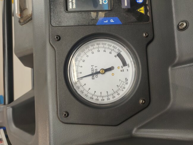

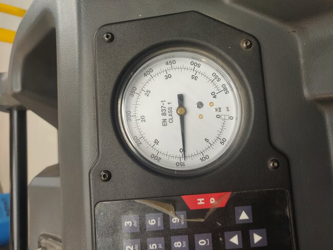

What are the high and low side pressure like now?
Aug 25, 2023 at 4:17 AM
TIESTO870
  • 23 POSTS
Thank you for your reply, and sorry for the late response. The low side pressure is at 105 PSI and the high side pressure is at 140 PSI. The ambient temperature were around 37 degrees celsius.
Sep 1, 2023 at 1:19 AM
  • 55,766 POSTS
Yep, the compressor needs to be replaced. Thanks for getting back to me.
