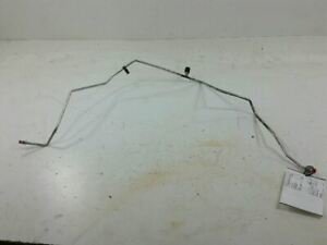

I need step-by-step instructions on how to replace the high A/C line
2006 NISSAN SENTRA
115,000 MILES • 1.8L • 4 CYL • 2WD • MANUAL
TOYPACIFIC
  • 159 POSTS
hey guys, the one from the firewall to the condenser.
So, kind of like the line in the photo. It's not the actual product but that's the line I'm talking about. Please, any details would help. Thank you

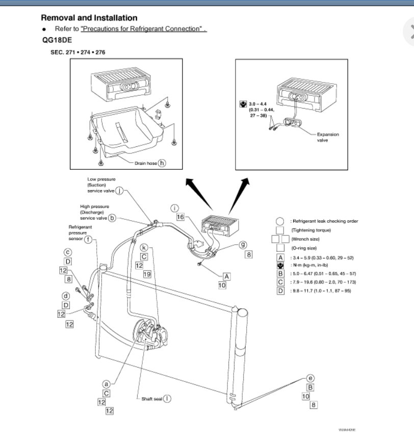

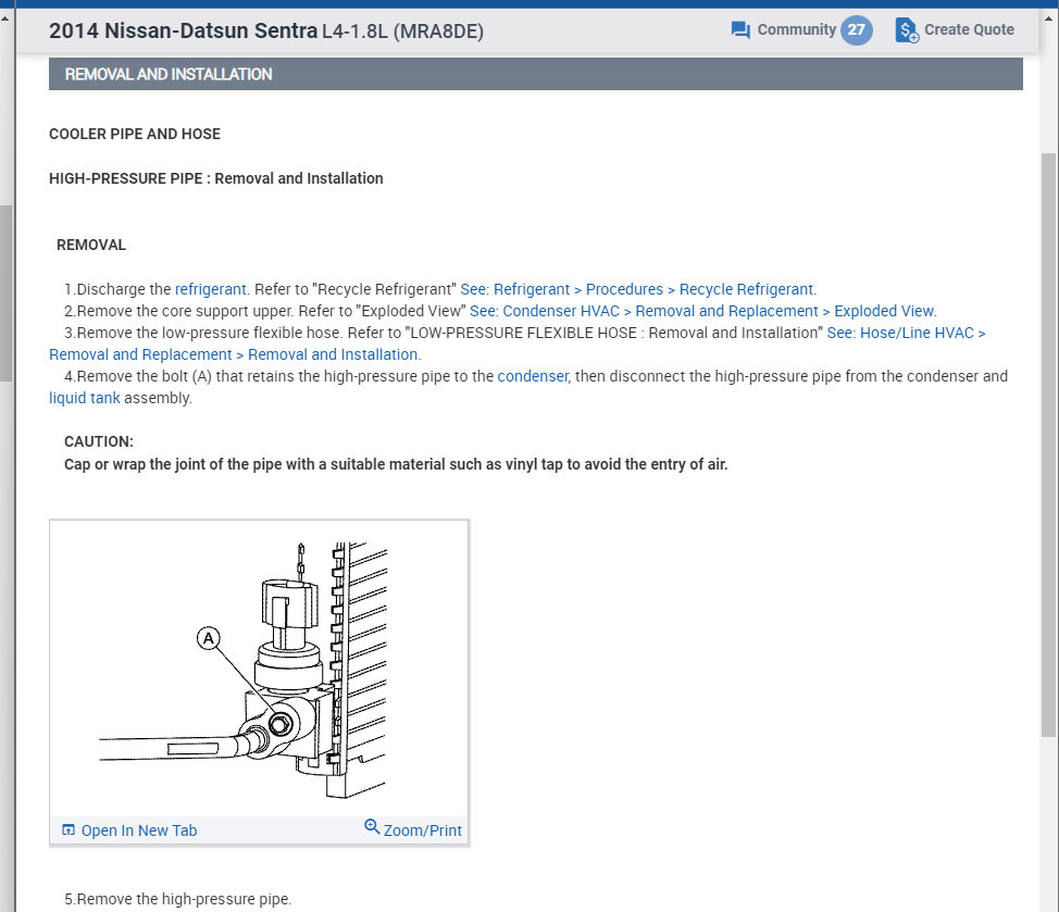

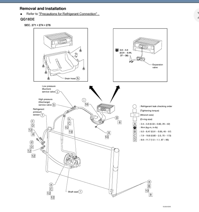

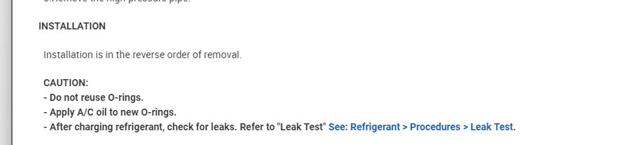

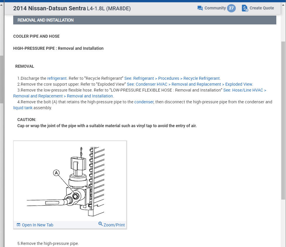

Unfortunately, the manuals are not that detailed for these lines. This is a common question on how to replace these lines, but they just don't provide that info in the manuals on these older vehicles. The newer vehicles have them at times but not always.
https://youtu.be/ON2dYcmXIAw
https://www.2carpros.com/articles/air-conditioner-how-to-add-freon
So, I had to go up to a 2014 Sentra in order to find the process. It is going to be close but these vehicles have changed over the years so it may not be exact.
Let me know what other info you need, and I will see what I can find.

Great got the job done, i apologize for this late reply i lost my phone which had my log in credentials in it but finally retrieved it. Thanks again, this information really helped me out.
