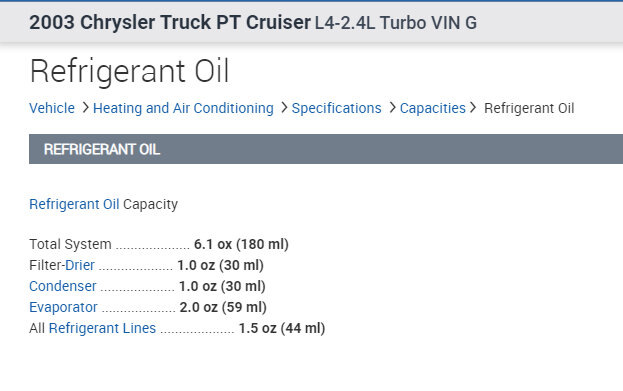

Completely replacing the A/C system, how much tag oil does it need?

Completely replacing my A/C system and want to know how much tag oil I need to add to the compressor and the dryer. can you please tell me? thank you

I attached a pic below that provides the capacity for different repairs as well as for the entire system. Make sure the new compressor is empty before adding the full amount because they are shipped with oil in them.
I hope this helps.
