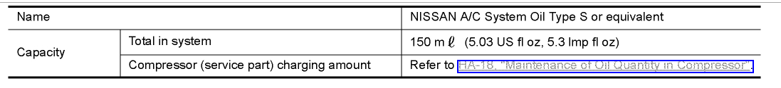

I am replacing the compressor, condenser, drier, and expansion valve. How much pag 46 oil would you recommend I add to the vehicle? Thanks for your time and help.
Jun 11, 2018 at 11:24 PM
  • 55,433 POSTS
With the system completely empty it takes 5 oz. Most new and rebuilt compressor come with oil in them so you will need to take that into consideration.
Here is a guide and a diagrams below to help you get the job done:
