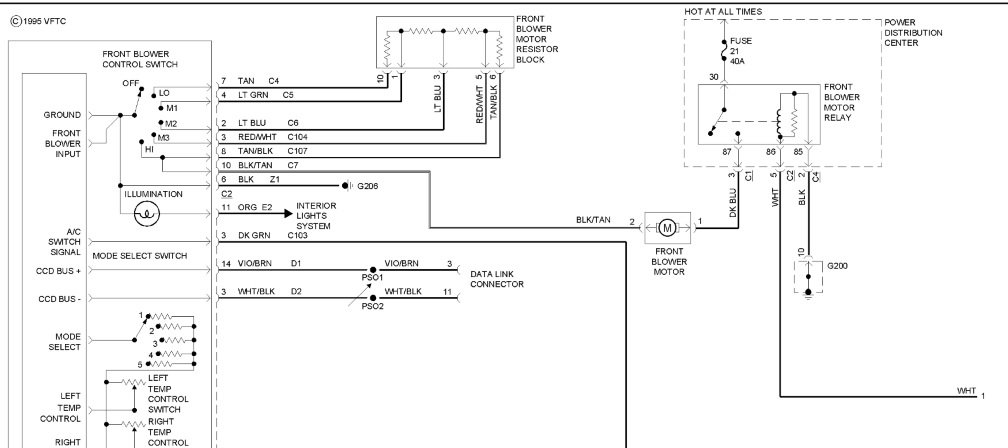

no power to fan switch.

Your talking about front blower relay? Note the diagram, check the fuses and relay. The blower motor gets voltage from that relay. Ground for the blower motor is controlled by HVAC module.
Image (Click to enlarge)
